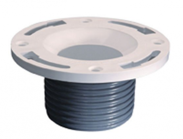

    Now I want to fix it right. I found this product, maybe my solution after cutting the existing flare fitting flush?
    Help... ironpony basod and anyone else!!

    You can buy flange adapters that bolt to the floor, looks like that might have been what was there. They come in both metal and PVC.

    cut it off flush with an oscillating tool, recommended in the other thread and then insert the flange you picked out. Might want to "grout" fill around pipe so the new flange sits flat on something.

    I also have to agree with Grizzly the flange that was there could be screwed to the floor and the toilet bolts are inserted in the slots. Again I would fill under the flange flush to the tile

    I don’t like the metal repair rings especially on a slab as the wax ring leaks it’ll just rust out before you notice there’s a problem.
    The floor flange looks proud of the tile which will lead to never ending ring failure and toilet rock. If you’re setting the new flange set it just shy of finished tile grade.

    Looks like that is what happened last time, I would recommend PVC.

    Yeah that would be my worst case fix. What I was thinking was the same as ironpony thoughts above... cut it flush and slip in the twist setup deal. Will try and report back.

    Subfloor and this will be a PVC fix for sure. I had never set a toilet myself before, so I bought the non-wax foam thing. Glad I did because troubleshooting this problem I would have wasted quite a few rings!

    My .02 as a remodeling contractor that sees this kinda chit all the time, no pun intended. Your solution is the best way to deal with it. Silicone the bejesus out of the whole thing when you jam it in. The only down side is the flanges will be above flooring.... use a perfect seal to make a reliable connection. Only flange seal I will install....
