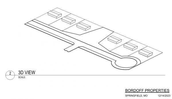

    He is building houses, I drew up some of his lots so he could get permits.

  12. Eric VW
    24,263
    139,280
    What software are using, B?
    Chaz, wildwest, eatonpcat and 2 others like this.

  16. eatonpcat
    9,451
    52,196
    Revit2024
    Work stuff is a little more technical
    Marvin, brenndatomu, Eric VW and 4 others like this.
