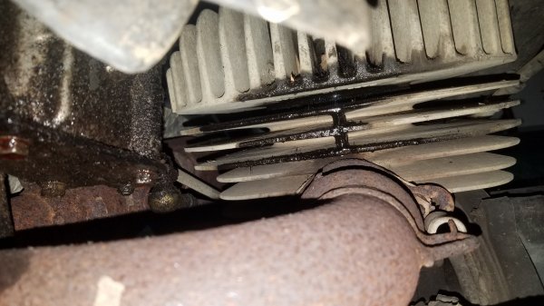

    2 stroke 250cc
    Air cooled
    Still runs just fine but oozes oil from head gasket onto exhaust pipe
    Oil injection system still works based on the amount of oil leaking.
    So does a head gasket just go bad?
    The gas tank is draining as I type, and I hope to have the head off tonight if the head bolts don't fight me.
    Besides cylinder scoring, what should I be looking for to determine the cause and solution needed?

  2. brenndatomu
    22,829
    145,573
    Is it the head or cylinder base gasket that leaks? They do blow out sometimes...often from improper assembly, or sometimes things just loosened enough to let it leak...you don't want to let it go, it can make a cylinder air leak...not good.
    But are you sure its not just the exhaust pipe gasket/joint leaking? Those are notorious for leaking on most 2 stroke bikes...and it blows up on the cylinder, looks like something else is leaking sometimes...makes a mess for sure
  3. bocefus78

    Pic.

  4. brenndatomu
    22,829
    145,573
    Yeah that pipe ain't leaking is it?!
    Looks like you could get away with just a head gasket then...potentially a 15 minute repair.
    Is it running ok otherwise? If so there is no reason to go any deeper than just taking off the head (unless you wanna freshen up the top end)...probably just 5-6 12mm nuts to remove, bam, you're in.
    Clean up both gasket surfaces real well...scotch brite works gooder...clean off with brake cleaner, assemble dry, no sealer. (put a new/clean rag on piston to keep any/all dirt outta the cylinder while you work) (good time to check the cylinder walls for scoring too, obviously)

    Yeah that really only looks like a head gasket failure. You might find a loose head bolt or 3. If you do, then that's a real good reason why a head gasket would fail. Should be a really simple repair, especially if the head unbolts with no drama. Being an air cooled 2 stroke they are about as simple as can be.

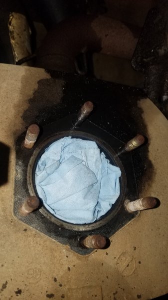

    Head came right off. The area where the leak is had loose head bolts.
    Any chance I can clean this up and retorque without replacing the gasket or is that foolish having it apart already? brenndatomu Horkn
    Edit To Add: Nevermind guys. Gasket only $20 so its already been ordered. :)

  15. brenndatomu
    22,829
    145,573
    If it is a fiber gasket no, one time use. A metal gasket can be painted with aluminum paint and put back on if it is in good condition and there no issues otherwise.
    The cylinder looks good I assume?
  16. bocefus78
    bocefus78
    Oct 14, 2013
    3,694
    19,837
    Indiana
    Little bit of exhaust side scoring. Visible but you can't feel it with fingernail. Almost guaranteed to be from when the oil line melted off of it last summer. Funding not available for any work to be done to cylinder, so it gets a gasket and reassembled.
    TurboDiesel, Horkn, eatonpcat and 2 others like this.
  17. lukem
    11,683
    61,970
    I wouldn't worry about that. Just put on the new gasket and run it till it pukes.
