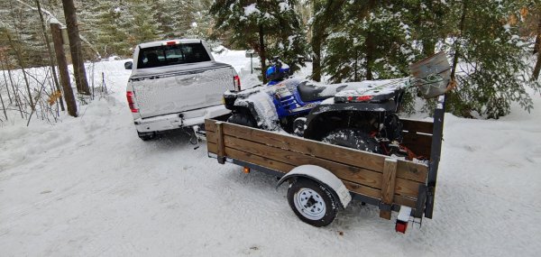

    What's up with the bucket on the back Horkn ?
    Maina, wildwest, M2theB and 6 others like this.
  8. Horkn
    27,941
    157,159
    Ahh.. there's the million dollar question.
    When the quad was nearly new, I bought dad this 5 gallon bucket holder that could hold 3 of them at the back of the ATV.
    Well, mom used the bucket holder to put 2 or 3 5 gallon buckets on it. She's full then full of crap. I'd actually have preferred poop to this garbage holding contraption. ;). The guy news from this eyesore is that it probably kept my mom from backing up the ATV into trees and such, as the round hoops took the damage. Here's the thing, in question. Screenshot_20200126-202738.png
    So this bucket is metal and dented. The steel hoops are been too. So this bucket would not come out. I tried sledgehammering it out. Nope.
    Well I ran out of time and knew it would stay the 200+ miles mostly freeway 70 + mph no issue.
    The sawzall will take care of the bucket. The rack that hold the buckets I'll take off and probably modify to be saw scabbards.
