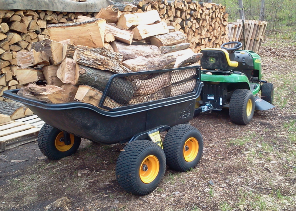

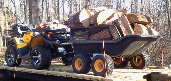

    I've had this -POLAR 1500 TA - since 2014 and have hauled 175+ cords (twice) with it over the years. I always load the thing heavy and have been told numerous times by my neighbor that I'm going to break it. :D
    One time from the woods to the pile to be split.
    Then one time from the splitter to where I will be stacking it.

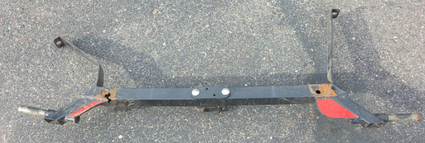

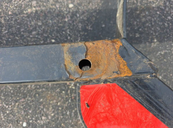

    The walking arms, as time passed, gradually started to have more and more negative camber causing the tires to ride more and more on the inside. It was getting so bad that the tires were starting to leave black lines on the road when driving fully loaded down it. This past Friday, as I was exiting the road and crossing the ditch to go into the woods, the axle finally decided to check out on the one side.

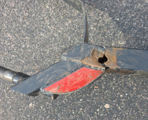

    You can see the bow to the axle itself along with the square tubing starting to stretch and crack where the bolts go through it and why the wheels had so much negative camber (before it failed).
    The other side was well on it's way to doing the same.

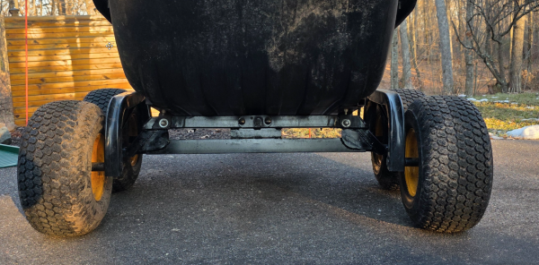

    I took it to a guy I know and he re-shaped it to fix the camber issue and reinforced it. So it shouldn't happen again. He did tell me that if I have any issues with it, he'll just make me new one from scratch. He took a WAG on setting the camber on the axle based on what I told him, as I only gave him the axle. I told him, if anything, to error on the side of positive camber. He couldn't have guessed any better! They both seem to have a bit of positive camber now.

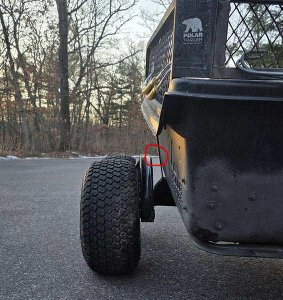

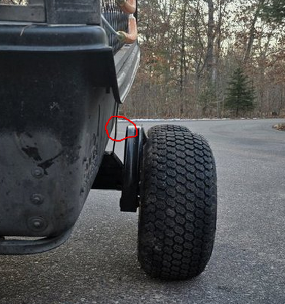

    More photos after it was fixed. Before the axle checked out, the distance between the walking arm and the plastic tub (circled in red below) was much less, was actually getting close to rubbing. So, guys who have this trailer and haul a lot of hardwood and load it like I do, if your wheels are starting to develop lots of negative camber, your axle may be ready to break like mine did.

    If you don't break something, how could you know what it is actually capable of?
    Those cracks *might* not have been from excessive stress...they could have been from something else that totally wasn't your fault.
    Seriously though, those gussets should have extended well beyond the holes....not just 1/4" or so. If you do have a new one made, aside from beefing up the square tubing wall thickness, make those gussets go at least 1" past the holes.

    I thought the same thing when I saw where and how it failed.

    I just looked and I can buy a -BRAND NEW AXLE- for $50 + shipping. If I ever would have to replace it, I'd probably just buy a new one and have it reinforced before I put it to use.

  10. brenndatomu
    25,097
    163,023
    This "truss" setup now ain't goin anywhere! :thumbs:
    At this point you'd hafta break/bend the axle stubs off it...next weakest link IMO, but not a likely failure.
