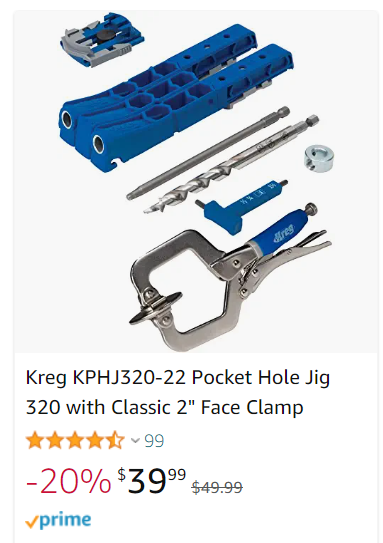

    You'll probably end up using it for more than you think. I use mine a lot.

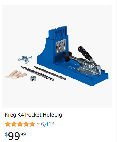

    I have this one and have built 50+ cabinets with it:

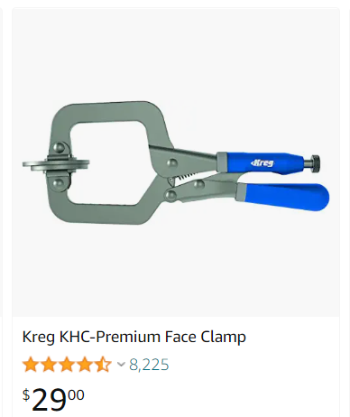

    You'll also want a pair of these to clamp down your joints, otherwise they have a tendancy to pull and leave one edge proud.
    If budget is tight, this would be the way to go.

    I have the simple 2 hole as well as a single hole kreg jig and lukem is right, you’ll find more uses for them once you get one. Handy tool!

    I have everything listed, Luke is spot on, great way to put some projects together fast

    Yes lukem is spot on. The Kreg jig os top notch. We have the bigger set with 3 holes and wings. Built many things with it.

    I have the cheap 2 hole Kreg jig, and I use it a lot. My only issue is that I need to double clamp it or one side will walk a bit and be too close to the edge. Wouldnt be a problem if it was one solid piece.
