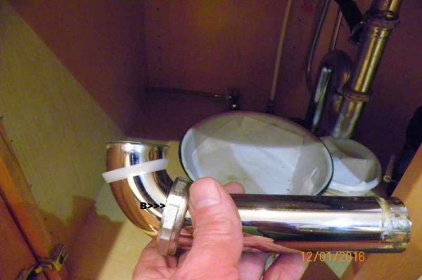

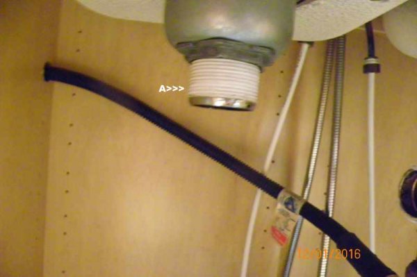

    Ok, why can't I get B threaded on to A? :hair:

    Try sliding the nut off of the elbow and see if the threads will start. Maybe the threads are boogered up?

  3. thewoodlands
    thewoodlands
    15,040
    62,333
    It goes on off the elbow.

  4. papadave
    82,468
    I think you've got the wrong plastic.....uh, gasket, or whatever those are called. Isn't that supposed to be flat?
  5. Grizzly Adam
    Grizzly Adam null
    14,196
    35,022
    Algona, Iowa
    Yep, that type of gasket is for the an unflanged pipe.

  7. Grizzly Adam
    Grizzly Adam null
    14,196
    35,022
    Algona, Iowa
    They also make flat rubber ones, usually in orange that should work.
  8. thewoodlands
    thewoodlands
    15,040
    62,333
    The crazy thing was that same type of washer was on that pipe, maybe that's why the nut cracked.
    Well Seasoned and Eric VW like this.

  12. thewoodlands
    thewoodlands
    15,040
    62,333
    I had it done by 8:40 this morning but we had a small leak so I snugged it up tighter and everything is good.

    thewoodlands get the Teflon tape off of the tailpiece. it will only ruin your day later. you need the flat tire shaped washer on the end.

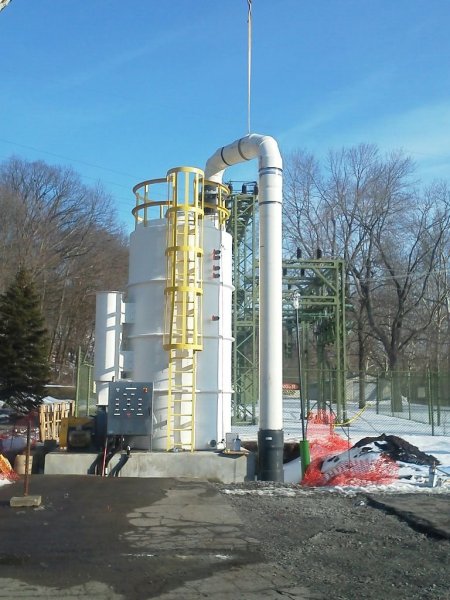

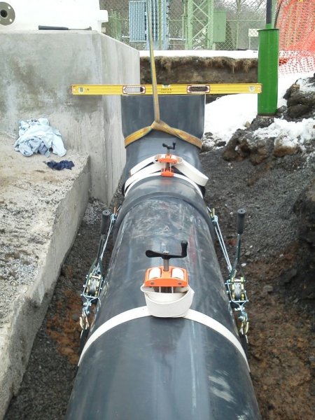

    I do little to no household plumbing, so pex is not my thing. I have done tons of schedule 80 pvc. up to 20" though
    Put this piece in with a crane:dex:
    I was surprised. a 20" 90 is only $1200
    :faint:
  19. papadave
    82,468
    Whoa baby. Now THAT'S some plumbing.
    I like the rigging to pull it together.
    basod and TurboDiesel like this.
  20. TurboDiesel
    16,154
    96,777
    You only get one chance
