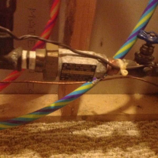

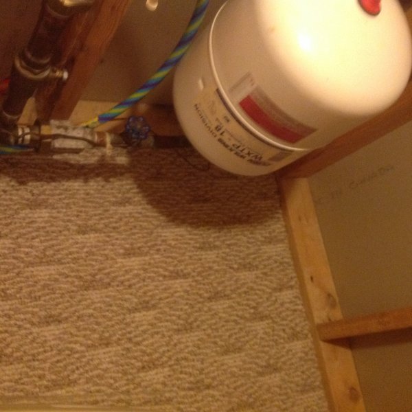

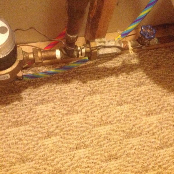

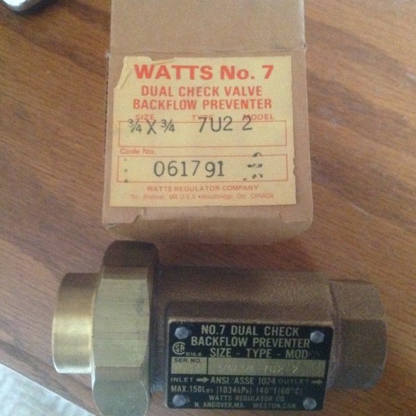

With my recent plumbing success and my graduation to master plumber, I feel embolden to tackle another plumbing issue. About 6 months ago, I noticed a fairly loud rattle coming from my pipes anytime we are using water. I isolated it, I think, to the back flow preventor. Is sounds like a rattle and resonates though out the pipes so you can hear it all over the home. But it's really loud by the regulator. When I put my ear next to the back flow preventer it definately sounds like it is coming from that. It's pretty darn loud. But I'm also suspicious that the expansion tank could be a contributor? And no I have not tested the psi yet in the expansion tank. I found a new old stock back flow preventor that I think is identical to the one I have. Since I don't know what I'm doing again, I would love to hear your input.
Wondering why there is a tee before the check valve and bladder tank. Should be easy to change the check valve since it has a union built into it. Use a very small amount of pipe dope, then 3 wraps of teflon tape, then another very light coating of dope on the male adapter/threads
I do not think that is a bladder tank, looks more like an expansion tank. If the expansion tank is bad you will get water hammer could be what you are hearing. The air inside the bladder in the expansion tank absorbs the water pulses, water does not compress, if it is not working all the "noises" will be transmitted thru the pipes.
the way it is plumbed neither should be hard to change, being you have the valve give it a go, if it continues move to the tank. To change the bf preventer the system will be drained a good time to check the expansion tank pressure, might change both at the same time.
It is an expansion tank, not a well bladder tank. Does that make sense? I realize there is a bladder in the expansion tank also. This is not a hammer noise, but a fluttering rattle. Still think it's coming from the back flow regulator? The tee goes to a sprinkler system. There is another back flow regulator just above the tee that is not in the pictures, but that one is not making any noise.

It's a constant noise whenever there is water demand, like the toilet, washer, dishwasher is consuming water. I have replaced the expansion tank before when the bladder failed and that was a knock whenever valves closed. This is a constant loud fluttering sound whenever water is being consumed. I have the new regulator , so no need to switch anything...
