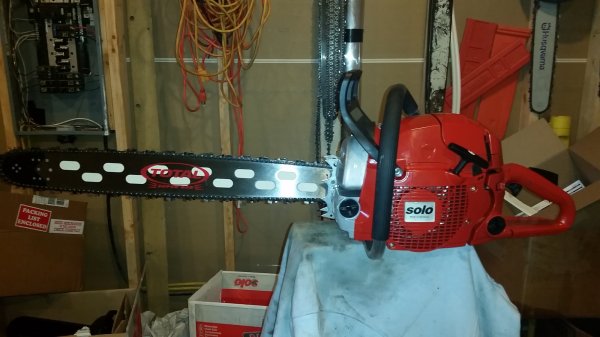

    Well I took my first stab at this 665/7910 solo hybrid build. I'm not super happy with the out come YET but she's no slouch. Needs a tad better chain! An unlimited coil and some break in time. This is cut 9 and 10 on a fresh build. Well get her all ironed out here very shortly! 20160216_164412.jpg

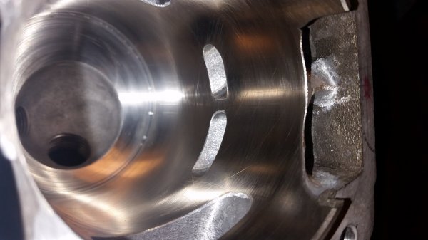

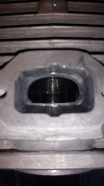

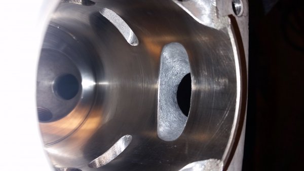

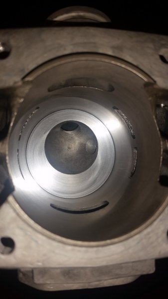

    Here's ya some pics and numbers DexterDay
    I took .057" from squish, gasket matched and reworked the lower trans, 100/128/81 is where I set the ports up at.
    Advanced the timing 7°
    20160215_173550.jpg 20160215_173555.jpg 20160215_173620.jpg 20160210_181833.jpg
