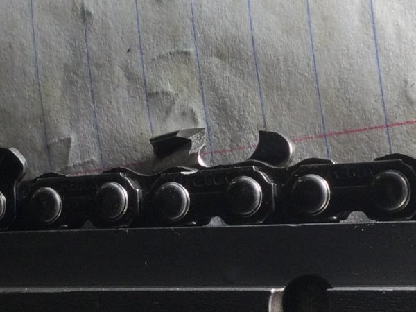

    I am always trying to learn a new skill or learn for myself what works and what doesn't. I have been reading up on square chain filing, and watching a few videos. I have never even seen a square filed chain in real life, just in pictures and videos although I was told one of my local Stihl dealers will make up a loop for me if I want of factory square ground chain.
    Anyway, it seems that many people will start with a round filed chain and convert it over. I finally got up the confidence to give it a shot. Unfortunately, no one had one of those double beveled bastard files, locally, which is what everyone seems to be using. The one Stihl dealer that seems to have the best inventory, has only the triangle files for the square cut chains, so I bought one of those to get started and ordered some double beveled files from Bailey's but it will be a little while before I get those, which I think are a lot better.
    The triangle file might be fine (has Stihl's name on it) for maintaining the factory square cut chain, but not so good for converting over from a round chain, in my humble opinion. But I decided to give it a try anyway, what the heck!
    So, I decided to convert the chain I currently had on my Jonesred 2255. I decided to sacrifice this chain because I didn't think it had much future left anyway, and it has these bent over sheet metal rakers on it anyway, that I didn't figure would continue to work well as I continued to lower them. You can see what I am talking about in the pictures.
    For a first try, and handicapped, IMHO, with just the triangle file, I was fairly happy with my first attempt. And it only too me probably 15 to 20 minutes. It's not great, or correct as such, and I have too much beak on the cutters, for sure. I didn't know what to expect when I decided to fire it up. I checked the rakers first and they were about .025 so I decided I was good to go.
    It was a little grabby, but not bad, really. It cut probably some faster, then the same chain did before, even when fresh sharpened. And it cut straight. I felled 3 or 4 trees with it, and bucked up some firewood and cut one double stump off really close to the ground, and got it slightly into the dirt, but did not seem to noticeably dull the saw. It's still cutting fine, and I made several cuts after the stump cutting.
    I know I have a long ways to go, but I am feeling confident that I can master this square filing thing. One thing I learned if nothing else, is that it don't have to be perfect to still cut pretty good. I can't wait to get a good file or two.

    I was all over the map on the beak and couldn't get the vertical right with the triangle file, but I held my top plates consistent with guide line on the top. And I held the file pretty consistently on a triple 45 degree. 45 down, 45 back, and tilted under the top plate at a 45, which was per an Iron Horse video on square filing, I watched.
    But I didn't get the corners to meet, so I almost always had a fairly pronounced beak, and of course I didn't get decent vertical cuts, but I don't think they really matter that much. However, that's where a good double bevel file comes in. Peferd makes a good double bevel file, I think, which Bailey's sells, but I am afraid they are on back order.

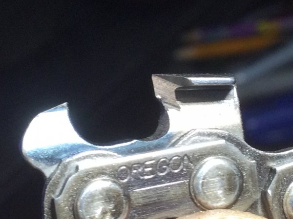

    The wide side of the file should be under the top plate, and the short side of the file needs to file the side plate. That corner of the file needs to line up with the corner of the tooth where the top and side meet. The side of the tooth should come down nearly vertical. Here’s one of my own pics that might be able to help you.

    AF039FB6-7005-4A7E-8F1B-21F1DFA113BD.jpeg F8D9DBDE-F371-4644-A614-D78AB06D29DF.jpeg Just repeating what the others have hit on here. Making the inside corner hit right at the outside corner of the cover is the most important part . Too low with the file ,and the chain will cut ,but won’t last .Too high , ,the chain won’t cut . It’s called side ,and top beak . Work on getting the corners first . The other angles like top plate, and forward lean can be adjust to suit later as you gain experience .

    Yep, I knew I didn't have the corner correct, I was too low, and had pronounced top beak, I guess you would call it.
