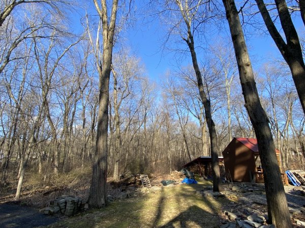

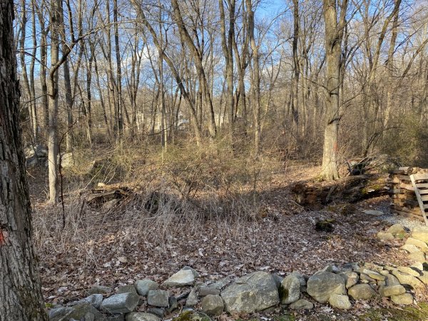

    So it looks like I came up short this year, which means I need another (and bigger) wood shed. I'm planning at least a 25x10x8 lean-to where those pallets are. I'm going to try and clear out as much of that brush as possible. Has any one used one of those chain brush grubbers? Are they any good, or does anyone have a better idea for those pricker bushes?
    Trees with the X's are coming down tomorrow. Thank goodness for tree removal friends ;)

    Nice looking area you have there Scarps! :thumbs:
    You can never have enough room when it comes to wood. Nice that you have the extra room to expand.
    Ive used old hand held hedge clippers to chop them and pulled them out by the rootball otherwise they keep growing back. Never have used a brush cutter. May be able to rent one or attachment for a weed whacker???

    Best solution to the brush is mow it if you have a rental center near most have the walk behind brush cutters some rental centers have the skid loader brush mowers that work great last is if you are going to use a weed eater to cut the brush they make a blade with chainsaw teeth on it they work great I sell a good many of those if you are not digging the stump out after you cut be sure to treat the cut stump with a herbicide to kill the root or it will come back JB

    I have one of those brush grubber. They work. Just need an ATV at least out better yet a tractor to pull the buggers out. A truck will work too, if there's enough room.
    That said, I think renting a brush cutter is the best option. I rented a billy goat hydraulic one a couple years back from my local hardware store.

    I have a brush grubber. Doesn't work very well. I usually just wrap the brush at ground level with a chain and attach it to my tractor. Alternately, cut it off a couple feet above grade then pull out the stump. Depending on what it is, it may come out easy or not at all. Honeysuckle in particular has shallow roots and comes right out, but you have to get it all or it grows back.
