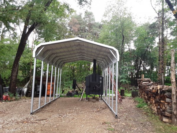

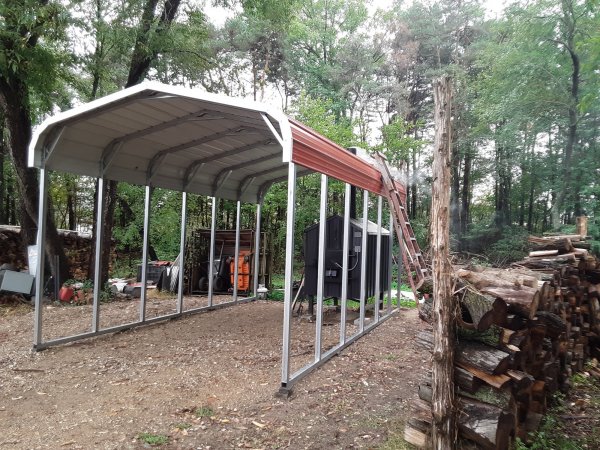

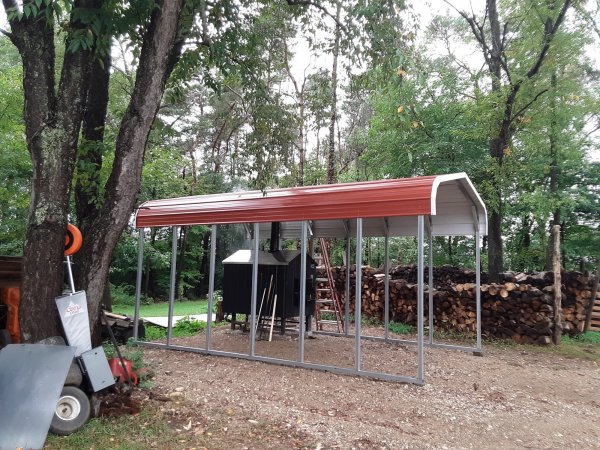

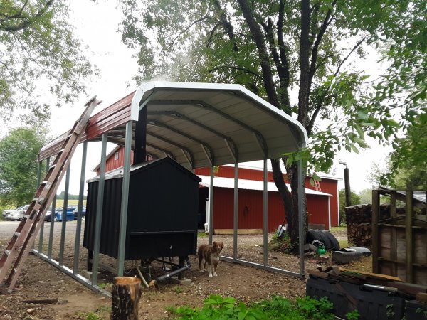

    Here she is! Covered up & making heat. So far I love this setup. We'll see what happens when it gets cold. Right now a couple of Pine logs once a day are doing it. Gotta get some wood stacked in the carport. That was put up this morning.

    Looking gooder Adam! I forget the details on the boiler? What did you anchor the carport with?

    I'm torn..
    :hair:
    Do I like the boiler most, or the carport??
    :hair:
    Overload!!
    o_O
    Nice setup amateur cutter
    :thumbs:
    Gonna enclose the sides as well?

    That boiler is good size which means that’s a good size carport to make it look that small!
    Does that help?:whistle::rofl: :lol:

    Rated for 5000 sq ft. 200 gal water capacity. I've got 3 100K BTU Exchangers + DHW. Carport is anchored with mobile home anchors. Shouldn't blow away.:D
    Nope, gonna leave them open for airflow. Just wanted to be out of rain/snow when loading. I can fit about 2.5 cord in there, so it'll have "wood walls".
    Carport is 12'X20' with 8' side posts. I went with the extra height to make sure my tractor would fit easily. The old M is pretty tall with the loader & exhaust.

    Very nice. That's what I'm shooting for too. I'm looking at a 22x24x7. I will have my boiler in the center of the carport (but still on the end).
    What brand is the carport? Quality appear to be good?

    All steel carports from muncie ln. Quality seems very good. I'm pleased.
