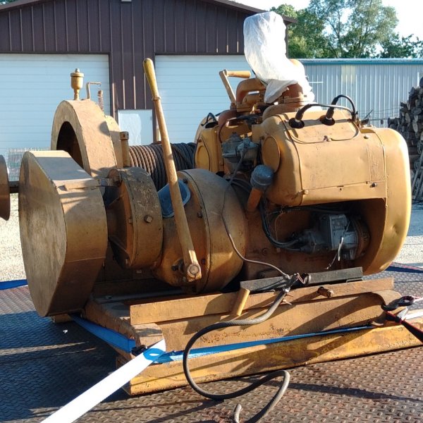

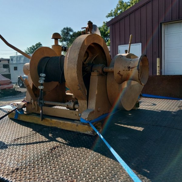

    "Cute little" V4 powered winch...:rofl: :lol: :thumbs:
    What's the plans for that one?

    What a log puller!

    That looks like the type of winch tower crews use when building them or putting up antenna's on them.

    That's cool! Very similar to the one on my crawler. Should be in the 25K pull range.

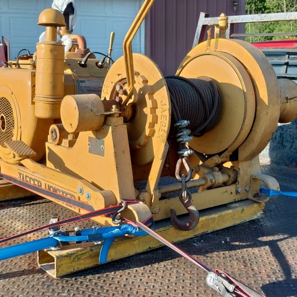

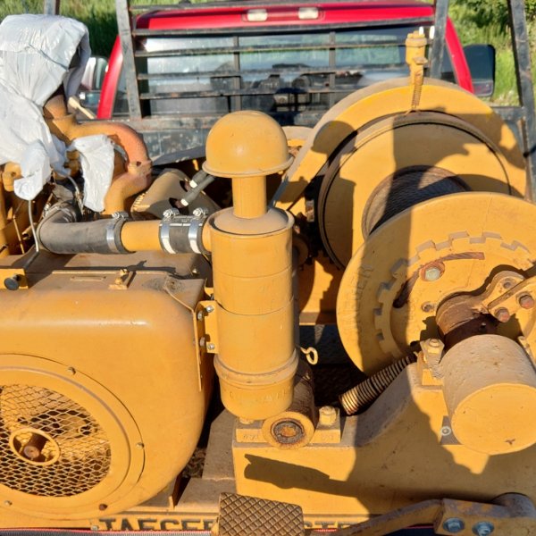

    Pretty close!! It's a Jaeger hoister for the elevator contraption you see on the side of tall buildings under construction.

    I'll use it for pulling logs and hung up trees and kid in the sandbox stuff.

    It won't be that strong but it's much faster.

    Saw it come up for sale and it turned out the owner had a stroke before being able to use it. Supposedly had to have the engine rebuilt do to water in the exhaust and it cost him plenty.
    He was going to skid wood for his sawmill.
    I was the only caller who didn't want to take the engine off for other uses. When he realized that I was going to keep it all together he really cut his price.
    I had actually bought and paid for it sight unseen last year right before I broke my leg.

    The way it's supposed to work is you tie a rope to the hook and run the rope down to a pulley anchored by what your pulling and back up to the winch. Then the capstan pulls the rope dragging the cable down to the load and when the load is winched up it drags the rope back up with it.
    Then the operator and the choke setter don't have to walk back and forth.

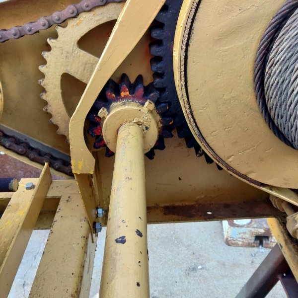

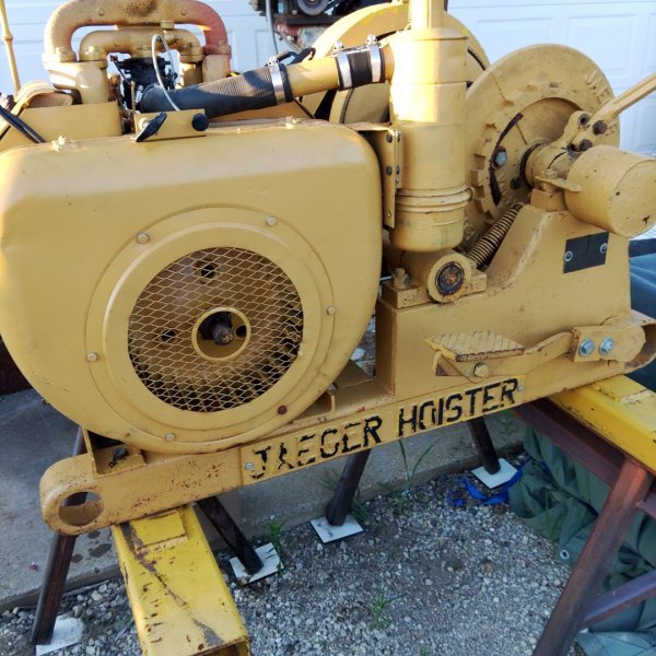

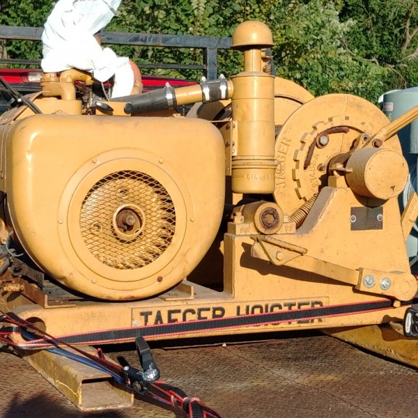

    At least the gears aren't pointy.
    Flushed out the gearbox and the oil pan and filled with fresh fluids.
    Has compression on all 4 cylinders.

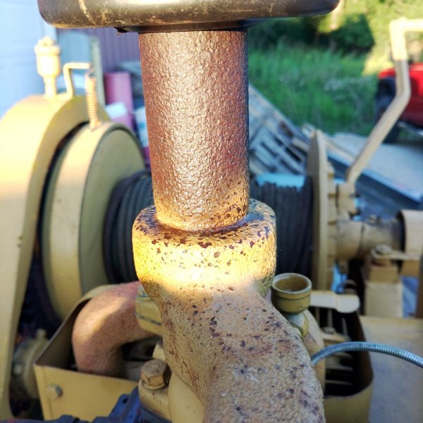

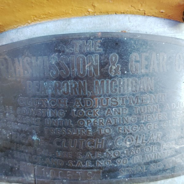

    Not finding anything on this company. IMG_20220817_092838_(1080_x_1080_pixel).jpg
    I'd like to put a proper muffler on, this might take a while....

    We have a standard/universal tractor muffler on our Wisconsin V4 powered pump...made a huge difference!
