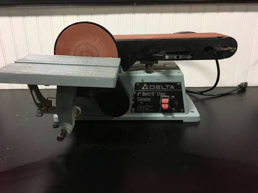

    I use a Delta benchtop belt/disc sander. The round disc side makes quick work of dressing bars.
    web pic:
    Eric Wanderweg and Screwloose like this.
