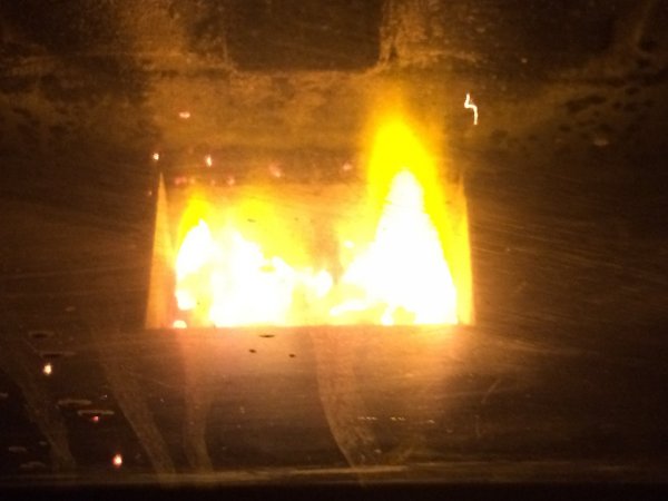

    See video of fire growing to a nice flame and then going down to red wood pellet coals.
    This is a 1997 Lopi Pioneer Bay fire YoYo effect.
    This may be extreme and seems like there maybe room for some improvement?
    Did you see this in your stove and what did you do to improve it?
    i.e. Change the auger bearing or the control panel?

    Don, flame looks good - it appears to be starving for fuel in the burnpot, at that combustion air rate.
    * I can duplicate that same condition here, by trimming pellet feed rate at a given combustion blower RPM (air rate).
    (How to fix on the Lopi, don't have a clue.)

    It's a nice looking stove Don - I can see why you would want to rehab / upgrade the Pioneer.
    Even though it may be 'aesthetically unpleasing', that burn pattern is very efficient (running 'lean'), and providing enough material remains in the fire pot so the flame doesn't go out, it shouldn't cause any issues running like that.
    * On the Francesca here, a 'top-fed' stove, there is always -some- variation with flame: depending on auger feed rate, air rate, and pellet length / quality.. This burn pattern is more apparent on lower feed rates on the stove here.
    So some flame cycling is 'normal' here, I think you will find as you tweak air and/or fuel, it will lengthen that cycle time accordingly.

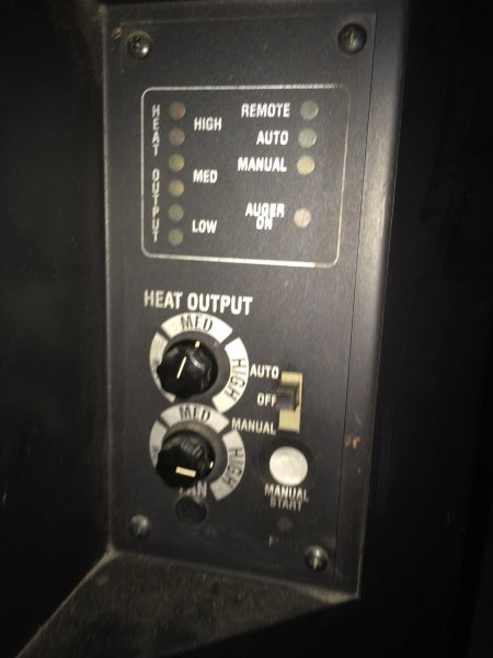

    Should it be better than this on Medium heat when the YoYo effect is low?

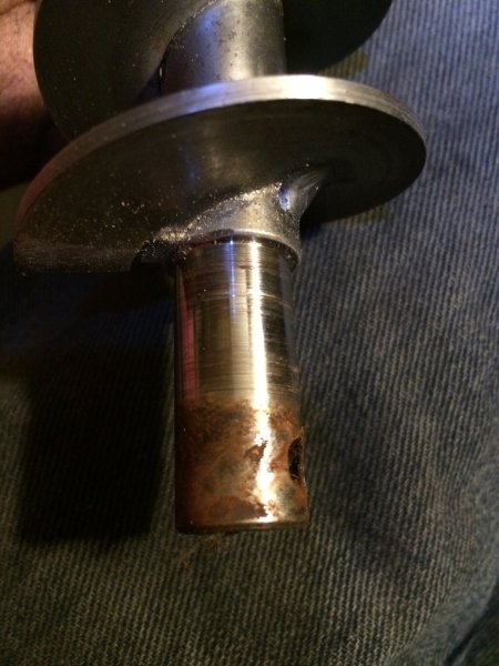

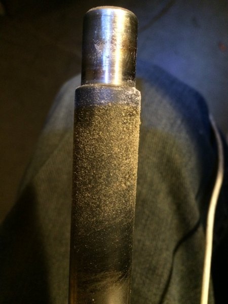

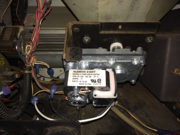

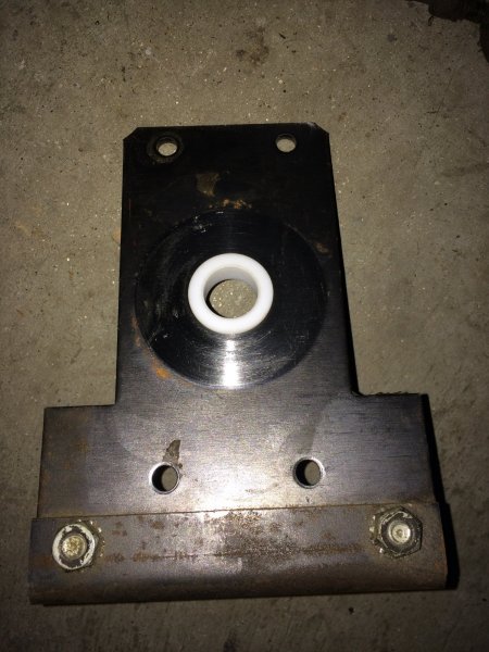

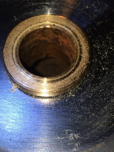

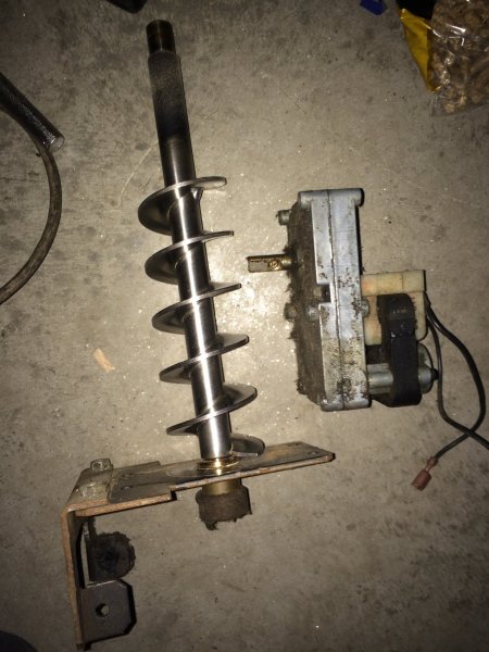

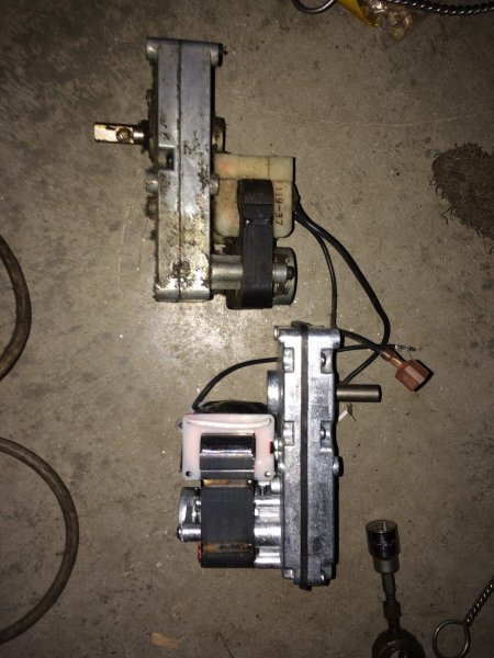

    Do you think a dirty auger and nasty dirty auger bearing and an auger motor with skinny mini magnetic plates contributed to this yo-yo fire effect?
    Will a buffed up clean auger, new hi quality GA auger motor and new hi temp nylon auger bearing help keep the fire from smoldering?
    See pics
    Pic 1 - Control panel heat setting shown on medium heat level
    Pic 2 - dirty auger and old tired auger motor
    Pic 3 - Dirty auger top
    Pic 4 - Dirty auger bottom
    Pic 5 - Dirty Bronze bearing
    Pic 6 - Old dirty auger motor with only a few magnetic plates
    Pic 7 - New high temperature nylon auger bearing in end plate
    Pic 8 - New auger motor, bearing and clean buffed out auger installed!

    If all that squaring and jigging does not help, NOTHING will.
    Looks great Don

    Cleaning up the auger and beefing up the auger motor and bearing keeps the fire from smoldering.
    Still has some yo-yo effect which is fairly normal according to the general consensus
    See pic below after new auger motor and bearing
