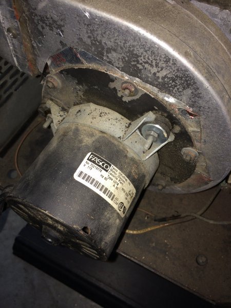

    Foil Tape and RTV silicone is not recommend for use in sealing pellet stove exhaust blower. High temp Foil tape is only good for 300 to 400 degrees F and high temp silicone is rated for 500 to 600 degrees F.
    Only the white lytherm is rated for 1,000 degrees F and makes a good seal at high temps.
    Also electrical tape is not recommended for taping wires because it gets brittle from the heat.
    Only insulated quick disconnects are Approved.
    Also the small sheet metal screws did not keep the exhaust flange secure. The bottom screw fell out and the whole flange can be moved back and forth breaking the RTV silicone seal letting smoke in the room especially during startup.
    See pics

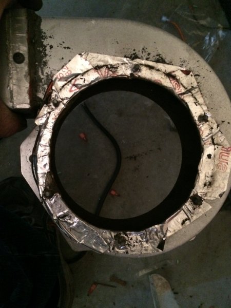

    Pic 1 - old noisy blower with foil seal with loose black case that rattles.
    Pic 2 - foil on housing

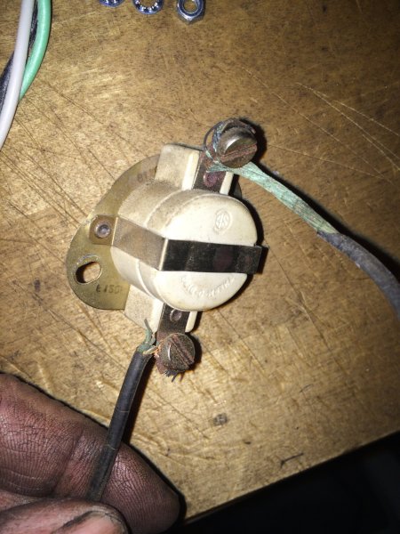

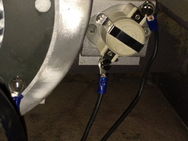

    Pic 3 - Low limit also called proof of fire or system snap disc.

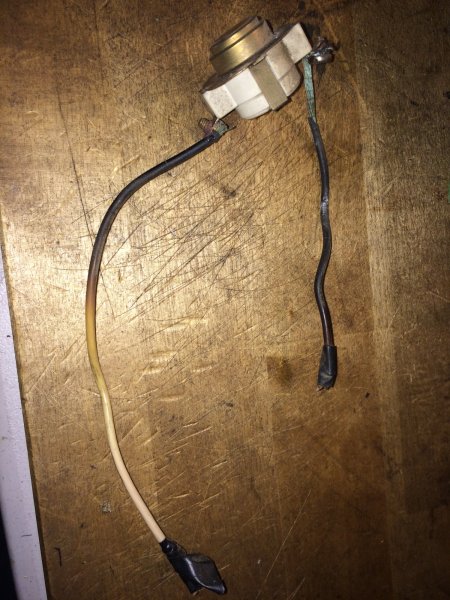

    Pic 4 - see green corrosion on wire! Room blower did not turn on and off with temperature like it should!
    Pic 5 - new snap disc with connectors

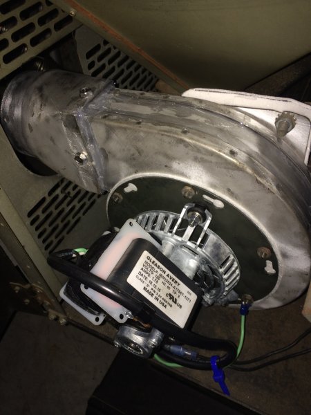

    Pic 6 - new open frame exhaust blower with more magnetic plates for more torque and no case that may rattle
    Notice new larger self taping stainless steel screws in exhaust flange with clear silicone for the best look.

    Good advice Don! We installed the new motor/impeller assembly on my Brother in laws furnace today! So much quieter now!!

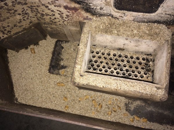

    The new upgraded blower keeps the holes in the burn pot clear so the stove works much better on the T-Stat!
