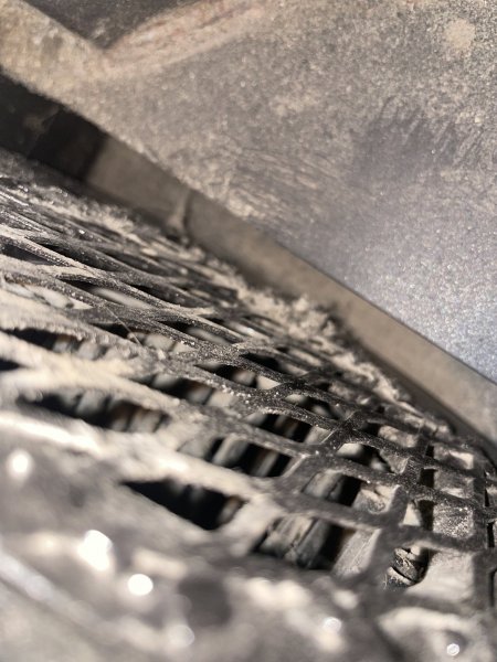

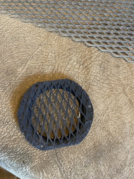

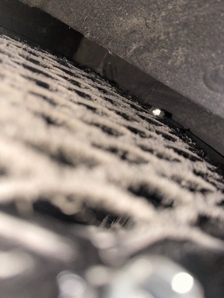

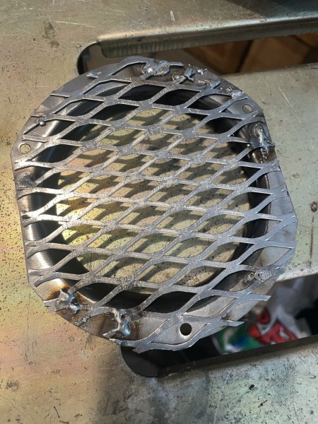

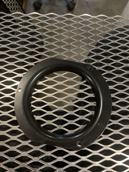

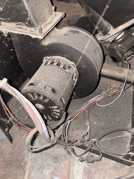

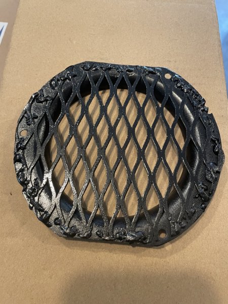

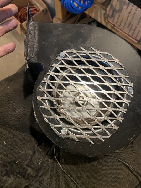

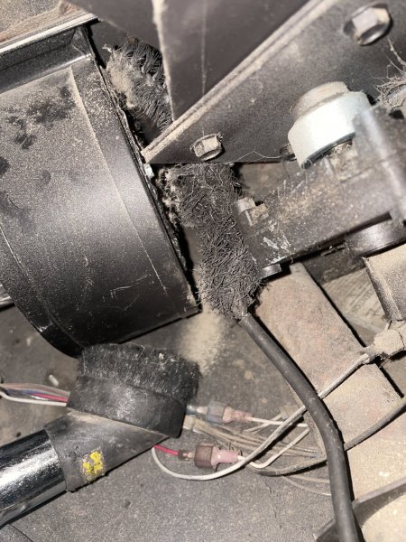

    Some stoves do come with dust screens built right into these squirrel cage blowers. Every environment is different but in this case with a golden retriever for a pet and a pellet stove insert with a convection blower on the left side with the intake facing in, right up against the hopper, auger chute and auger motor it is so tight that it must be removed to dig the dog fur out! After a couple months of winter with not much outside activities the blower started building up with this fluff & refuse so the flow of heat was really stymied! We had to try something and after a year, I am happy to report it could not have worked any better!
    There are some blower screens available and easy to purchase unfortunately the more common size was discontinued and the only size available now fits relatively few pellet stove convection blowers!
    Also the screen is made of round wire type rods with good spacing but not the best thing I have seen. Therefore we picked flat slat type mesh with good spacing and amazingly it keeps all the junk out!
    So after purchasing a large piece at the local Home Depot, cut and fit it. Then I welded it to the trim ring and painted it to match. Attaching it to the trim ring makes easy removal for deep cleaning and the ability to transfer it to a new blower !
    Now this convection blower can be easily cleaned by brushing the flat slats with a furnace brush from Home Depot and a shop Vac :)
    Your result may differ but has anyone else tried this??
