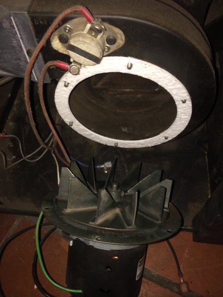

    Been thinking of doing this for a while. How does it look?
    How to clean your pellet stove exhaust blower or when to replace it with the upgraded "Low Drafter" blower.
    The exhaust blower in a pellet stove pulls air into the burn pot for combustion and then pulls the heated air across the heat exchanger and pushes the air and smoke up and out the flue venting.
    This blower must be in top condition for the best combustion to completely burn your pellets and provide the most heat and comfort.
    Therefore this exhaust blower should be cleaned and lubricated at least once per year.
    If the exhaust blower is faulty, it should be replaced
    This video shows what goes wrong with these blowers and the best upgraded replacement.

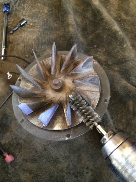

    Here is some suggested ways of cleaning the exhaust blower with simple brushes and lubricants.

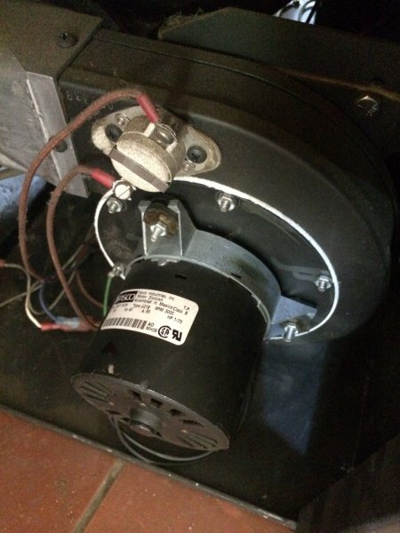

    Remove the exhaust blower, unclip the 2 or 3 wires and unbolt the 6 nuts or bolts, then pull out the exhaust blower.

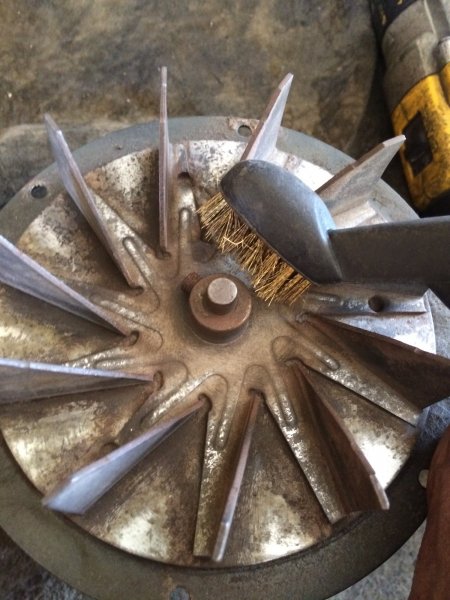

    1. Brush the impeller blades

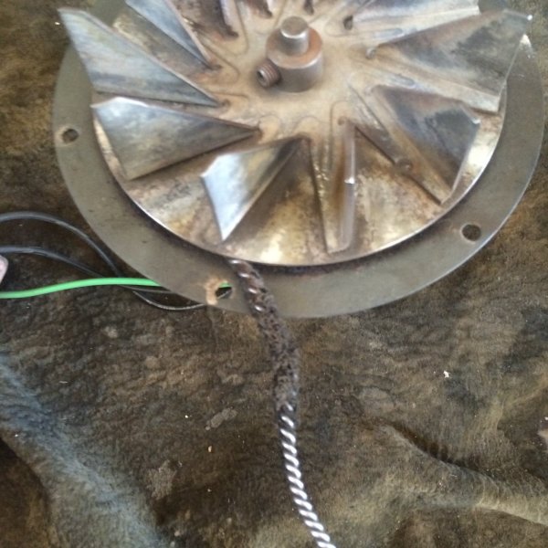

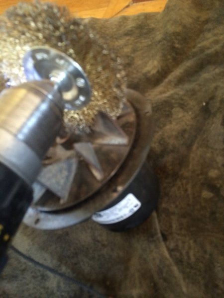

    2. scrub blades with cylinder wire wheel

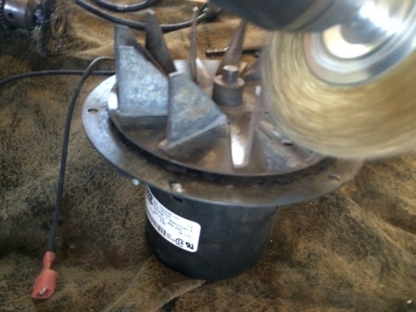

    3.-4. scrub blades with larger wire wheel

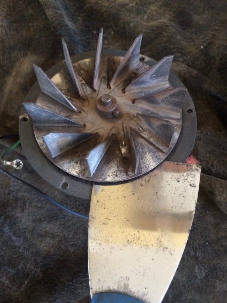

    5. - Scrape under impeller blades
    6. Brush under Impeller blades

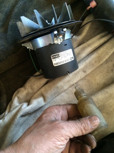

    7. Oil motor and motor shaft

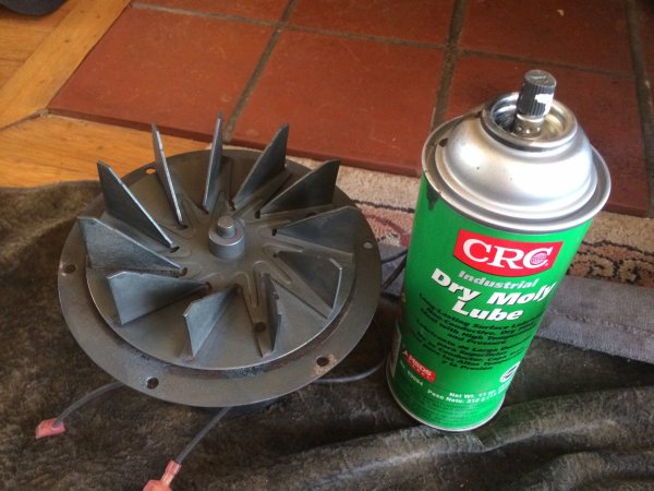

    8. Spray Dry Moly on impeller blades.
