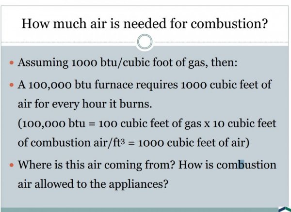

    I've been diggin! Here is what CAZ stands for. And the scale is in Pascals.
    Combustion Appliance Zone (CAZ) pressure in pascals. Minimum BPI guidelines of -5 pascals. Still looking for a definition of how the testing is done. and If there is any call outs for best possible combustion.
    All I could find is rated for natural gas appliance. See pic!

  6. jtakeman
    12,309
    55,490
    Ok what I found is that they recommend this formula be used for a base to ensure you have proper Combustion air. Seems to be the standard for all combustion appliances from what I could tell.
    I could not find anything on peak or best.
