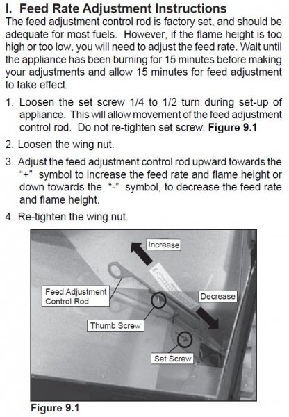

    Timber Heat cranked lots of heat for me last season. I haven't seen them this season(things often change). I'd definitely try a few other known hot brands to see if the stove perks up. Before you go spending on parts or pellet, Try the simple things first.
    Have you set the flame height? See attached pic from the manual.

    Is the "set screw" supposed to limit how far you can open the control rod or the rivit it hits?
  9. jtakeman
    12,118
    54,581
    If the rivet hits the setscrew, Thats about as much as it will open. IIRC. If your flame is still too small. I'd say to much air. At that limit the flame should be licking the baffle.

    Not saying I need to have it wide open. what I am saying is that the set screw is not limiting the adjustability. A rivit hits the very top of the adjustment rod. Seems like it should be the notch for the setscrew not the top of the rod hitting a rivit.
