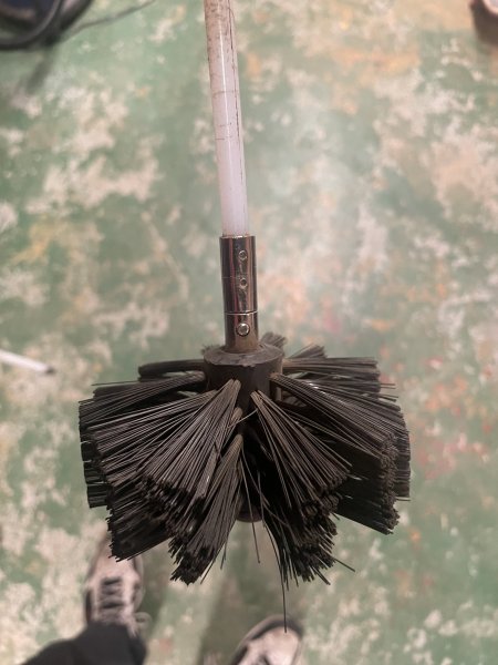

    The Pellet cleaning rods small button lock popped apart & 18 feet of rod & brush stuck in 35 foot 4” diameter liner!

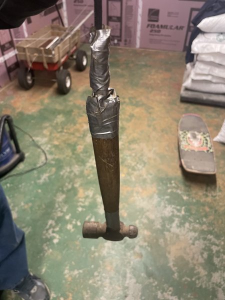

    Therefore the best solution that worked for us was a ball pean hammer with a long nylon rope firmly attached by drilling a hole through the hammer for the rope! The weight of the hammer enabled us to pull the rope up and down to punch the rods down and into the fireplace!
    Now the final fix is to use better rods with a large oblong button lock that are heavy duty. Also the spring end enables the brush to bend and move up & down the liner better.
    P.S. I have tried the screw together type rods but I have had them unscrew and come apart too!
    Pic 1 - Shows rods with small button lock
    Pic 2 - The fixer! A ball pean hammer with a long nylon rope firmly attached!
