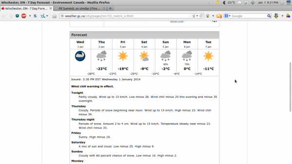

    Anything below 25 degrees or so, it starts to struggle. However, the next few days are going to be very cold. The temp tomorrow with the wind will be -39c. At that temp, f or c it's all the same.
