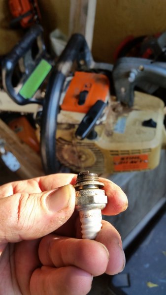

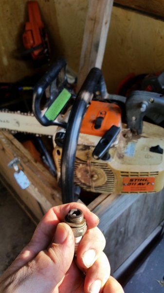

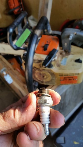

    For about 6 to 12 months my 011 has not been working. I used it last fine then went to use it again and it was acting like a bad coil or something .
    My compression gauge has gone kaput so I didn't try it. I swapped carbs (off a parts saw that was running till it was straight gassed...not by me)on it pretty sure that was not it sine it wouldn't really run of I put gas in carb.
    I tried on and off over the months but with so much other stuff to do and several more working saws I didNT bother. I always ended up frustrated so I would stop. I am not sure why I never checked the simple things...I guess I assume they almost never go bad??:hair:
    So today after I kind of stopped splitting and stacking I grabbed it to mess with it. Fueled it up started to pull cord. It sounded like it had an air leak and no compression. So I pulled the plug boot and the ceramic was just spinning!!:eek: it was would pull up and down, no wonder it sounded like there was blow by!!. Grabbed a plug out of the other cylinder and was good to go.!! GlaD too I like that saw for one handed work and for small stuff as it is pretty torquey for its size.

    Sometimes the simple things will get you.
    No fire without a spark, :) cool you figured out the problem:thumbs:
