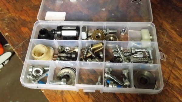

    There is a kit on eBay that comes with a fuel filter, spark plug, recoil dawgs, and numerous bolt sizes, nuts, E clip and washer for clutch cover, etc. It is about $20 IIRC.
    I have used quite a bit out of mine, or just replaced old with new. But this gives you an idea. This kit has what you need, plus anything you should need to replace in the near future.
