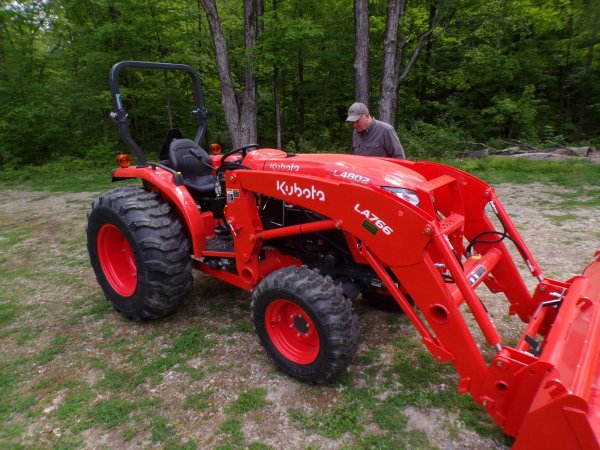

    I'm gonna be A$$holes and Elbows getting my 3 year plan back to size come spring. I'm gonna put them on my Kubota. I have the bucket but I want a set of forks for moving the splitter and other things...

    The full load lift rating is, 2,147 lbs. I am not going to be using the forks for and huge items. Mainly to lift logs off the ground to cut and get to the splitter. :) I'm not picking up those 200+ pounders any more. My body just isn't gonna do that, I did that long enough. My Kubota will be "Babied" and live it's life in comfort. :cool::yes:

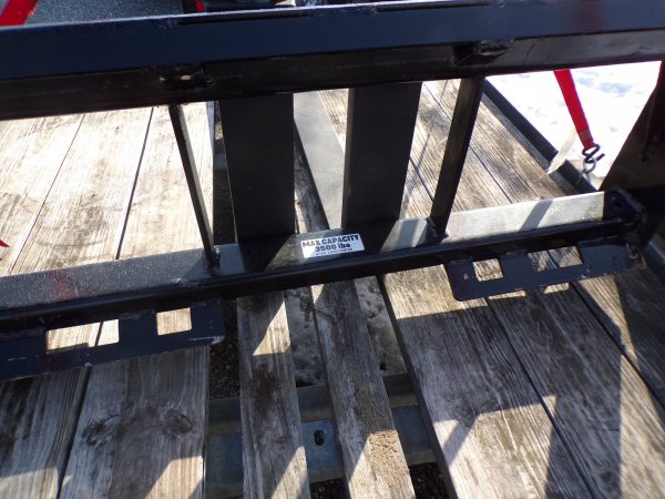

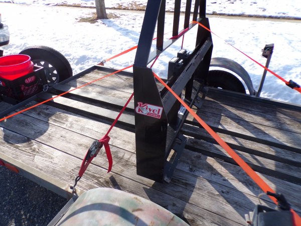

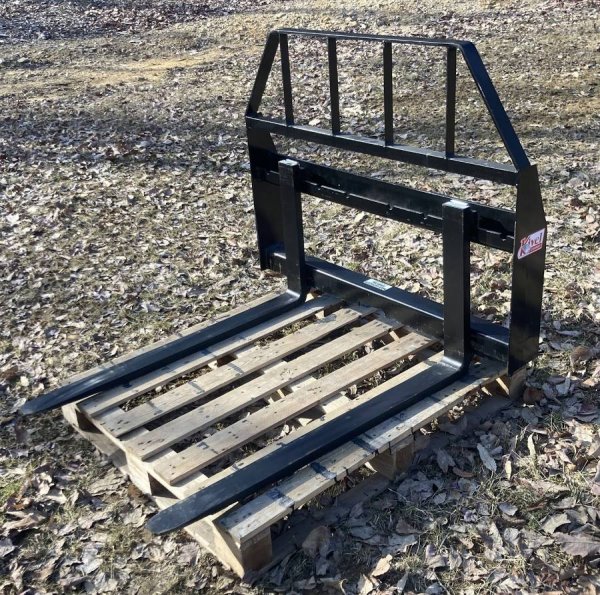

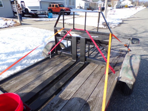

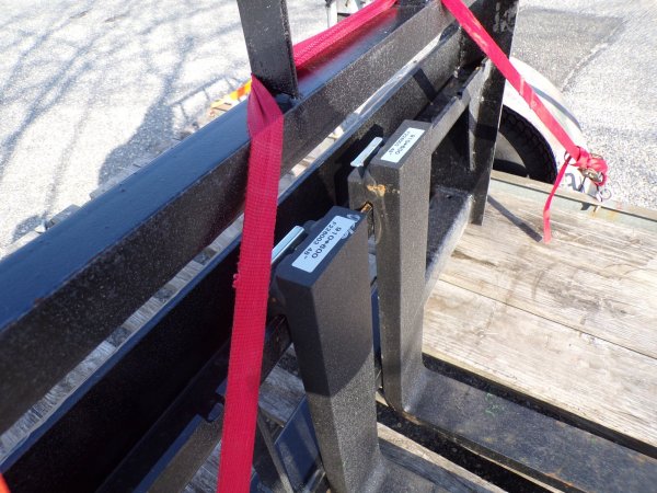

    So, I called this dealer. Really nice guy, a small business of equipment repair and sell these Kivel forks. He said the 2000# set was $650.00 and the 3500# set was $695.00. HA! This was a no brainer! :D:yes: So, I drove my happy self up the road 56 miles :binoculars:and bought the 3500# set! (with) 48" forks instead of the 42" on the 2000# set. I can't beat this with a big stick!! :deadhorse: So the story is, these are 100% American made in Missouri and the company started in Pennsylvania. The family business moved to Missouri for what ever reason. They are an Amish group The guy gave me the rundown briefly. They are beefy and for what I'm gonna use them for, they'll be fine, and for $695.00, you ain't gonna find a set any cheaper!
