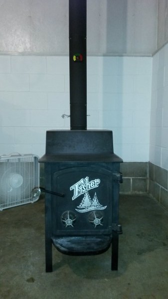

    I really want to do two things with the Baby Bear this spring/summer.
    1) get my baffle in.
    2) paint the trees and logo.
    ...so how have you guys painted them? and what color of Stove Brite did you use? There is no way I am going to mask it all off and spray it. So, hand paint? brush? roller? my cat's tail?
    Thanks.

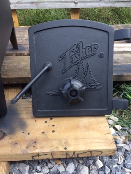

  13. WeldrDave
    9,418
    49,429
    No, Aluminum silver oxide boiler paint from Ace Hardware and a sponge brush. I'll dig it out and take a pic later today for you :)
    Found this! Exact same stuff, newer label, I just had an older can. Ace Interior/Exterior Chrome Aluminum Paint - 1/2 Pint - Ace Hardware & Home Centre, Maldives
    shack, wildwest and Well Seasoned like this.
  14. WeldrDave
    9,418
    49,429
    shack, I just took the doors off and laid them flat and slowly painted them with a sponge brush. The paint is thin so "take your time" But it'll "never" burn off. Good stuff and good looking.
