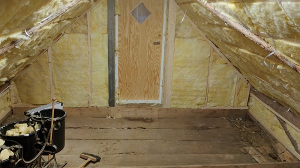

    I have an old barn that I didn't use for anything else you than store a couple (ten?) of years of firewood
    I decided that the loft I going to use as a painting studio. Maybe I do some spray painting there as well.

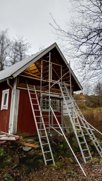

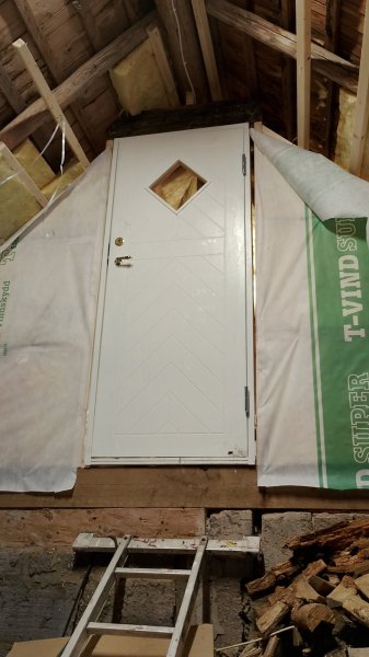

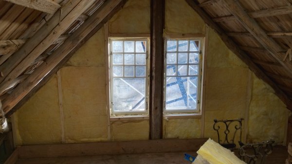

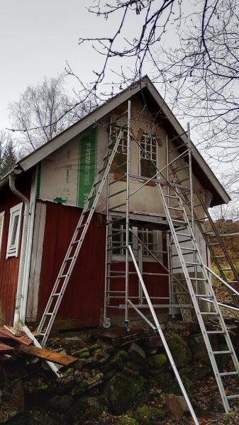

    The problem was that the wall didn't stop the wind. So I had to remove the old siding
    I found a couple of old cool windows that I couldn't resist to use
    Now that wall has about 5 and a half inch (13, 5 centimeters) of insulation, a proper wind barrier and broken thermal bridge.

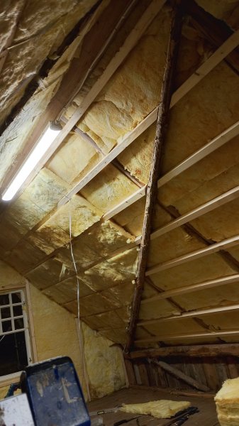

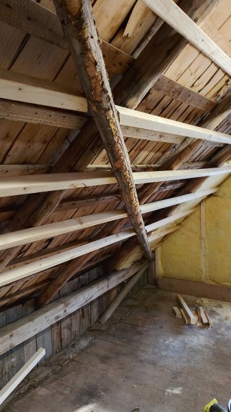

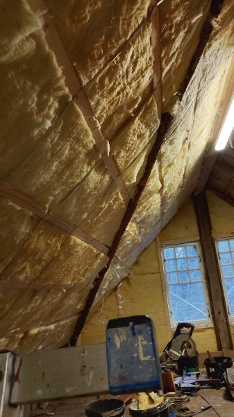

    Next step was the ceiling
    It's only about 7 feet in the centre. So I only used about 5 and three quarter (14 centimeter) of insulation.

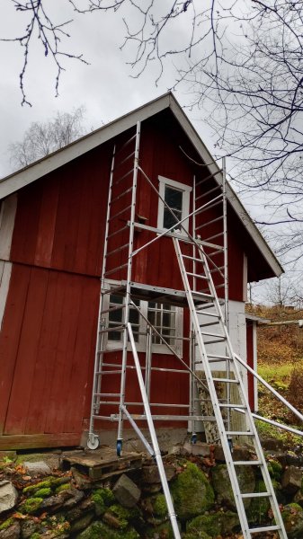

    Next step is the other gable that I just started on . So picture will come. When that gable is insulated I can have some heat on so I can start fix the inside.
