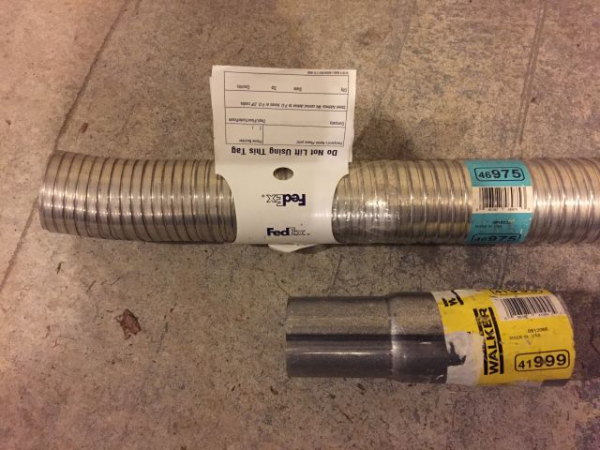

    I was planning to install my OAK earlier in the fall and never got around to it. Well, I'm back to it - hoping to get it installed this weekend. I ordered an exhaust adapter to reduce from 2.75" Harman flange to 2.5", and also ordered a 2.5" 6 foot flex pipe. The high level plan is to attach and run the flex pipe up into the same 8" SS fireplace liner where my 4" exhaust flue already runs. I will simply move the 4" flue gently to the side, making enough room to run the 2.5" OAK right along side it, just a couple of feet up. I will also attach some aluminum screen to the end of the OAK flex pipe with a hose clamp, to keep out any debris that might somehow make it into the 8" liner. I know, it should never ever happen, but better safe than sorry.
    I need to insulate the entrance to the 8" SS liner, all around the flue and OAK pipes so fresh air can only come from the outside and not from in the house, and also so no cold air will come directly into the house. Here's where I'm stuck: I can't find roxul / mineral wool / high temp insulation to save my life. Yes, they have it at Lowes and Home Depot, but only in car sized quantities. I only need a little bit, and can't stomach the thought of paying $45 for a massive bail when I only need 5% of it. I have called every hardware store and stove shop in the area and either they don't sell it, tell me they will get back to me when the stove repair guy gets back with the van (which they never do), or want to charge the same price as Lowes or HD, only for a single serving size! This is just insanity, of all the things to get caught up on? I have thought about using plain old pink fiberglass insulation because it's real easy to come by small quantities. It's one of those topics that triggers strong sentiments though. One person will tell you it's absolutely fine, another will tell you it will light on fire and your house will burn down the first time you light the stove. I just can't win here. Can I get some advice on this? Does anyone know where I can buy a small quantity of mineral wool for a reasonable price?
    Last but not least (promise). The idea of running the OAK pipe up the 8" SS liner infers that I will have free air flow coming down from the top. I have read in several places "just drill a couple holes up at the top to let the fresh air in". OK, I get the concept but I'm not exactly comfortable doing it. The 8" SS liner extends up about 2 feet past the roof line, so I have plenty of face area to drill holes. The Harman manual says the OAK air intake should be at least 12 inches from the exhaust flue. Fine, I will drill the hole(s) at least 12" down from where the 4" exhaust flue exits the 8" liner. Questions: The air-intake hole in the stove itself (behind the flapper) is only about an inch diameter. How many holes should I drill at the top? 1, 2, 4? What size? 1 inch? Half inch? Do I need to cover the hole(s) with screen to stop the wasps and hornets making their way in as soon as warm weather returns? Assuming I do, is there a "clean" way to put screen over the holes I just drilled in the SS liner? Do I just cut a makeshift piece of aluminum screen from a roll and apply it over the holes using high temp silicon or self tapping screws? Seems shoddy and I don't know how long it would last anyway. I also read that drilling holes may not even be necessary because there could already be sufficient air flow without them. I suppose this suggests the possible presence of air leaks in the flue that shouldn't be there, and I really don't think that applies to me, nor do I want to potentially starve the stove of fresh air by assuming there is already sufficient fresh air flow when there really isn't.

    Exhaust parts arrived today. Amazed at how well the exhaust adapter fits over the air intake flange on the stove. Perfect fit!

    hopefully all those parts are Stainless (or aluminum)? Intakes get cold, and can get copious amounts of condensation in fall and spring, depending upon relative humidity.......it'll be a rusty mess if it isn't

    Flex pipe is aluminum and adapter is aluminized finish. Still no joy finding roxul. I'm making a last ditch attemp to find some at a stove shop on my way home tonight. FYI I'm planning to drill two or three 1" holes at the top and cover them with 1" round screened aluminum vents - found some on Aubuchons website. Will take pictures of everything along the way.
