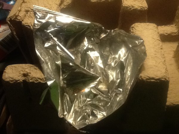

    Well, old barrel belly got down and in behind the stove. And what before my eyes did appear. One shinny tin foil wrapper plugging the gear!
    My cats love to play with those foil wrappings. I'm betting one of them took it back there hi hint it from the others.
