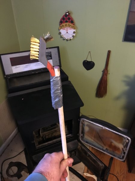

    Stove has been running like crap and this morning I noticed the status light was blinking 3 times.
    My stove is shoved into the corner so I'd like to clean it without removing it. Any tips?

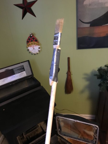

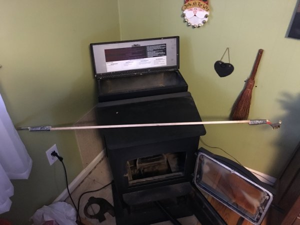

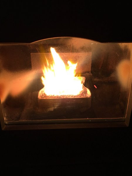

    Custom tooling....stove is starting up with Okanagan Douglas firs....fingers crossed

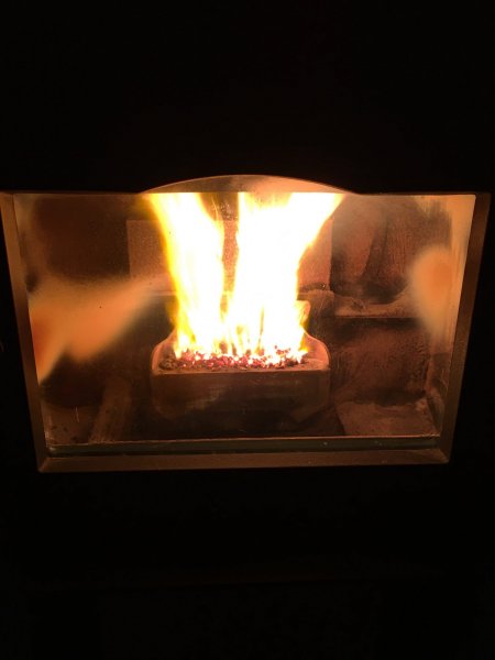

    10 minutes in......

    I'm going to say I got it, I purposely only cleaned the ESP probe and brushed off the combustion blower.
    The probe was filthy. I must have missed it in the yearly cleaning, it will now be part of the monthly as it was simple.
