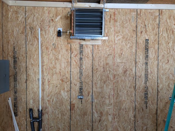

    After all these years I'm FINALLY ready to hook the OWB up to the shop. Any recommendations on heat exhanger / fan units? I'm heating about 1,000 sq ft of moderately insulated space.

    Are you thinking like a modine style heater? Just not needing any heat to be made in the unit, just a heat exchanger with a blower?

    I know amateur cutter has some in his shop. I have seen some really nice systems made from vehicle radiators. The older style with flanges on the side makes it easy.
  7. brenndatomu
    22,651
    144,183
    Beat me to it... I've seen some very affective shop heaters made up of an old car/truck radiator with a box fan zip tied to it, on/off controlled by one of those stand-alone 120v thermoswitches :yes:

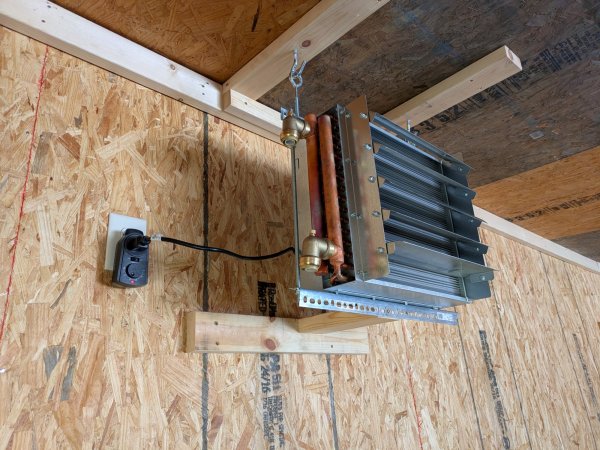

    I've considered making my own, but honestly don't really have the time or energy to find the right mix of radiator surface area and airflow to deliver the right amount of BTUs per hour. Calculators say 50K BTU will be more than plenty...and I'd rather have a small unit that runs a lot than a big unit that cooks you for 1 minute then freezes you, and repeats. I'd rather spend a couple extra bucks and pull something out of a box and run it.
    I do know I'm just going to run a wifi plug with a thermostatic plug sitting on top of it. That way I can turn on the heat in the morning from my phone to warm it up.
