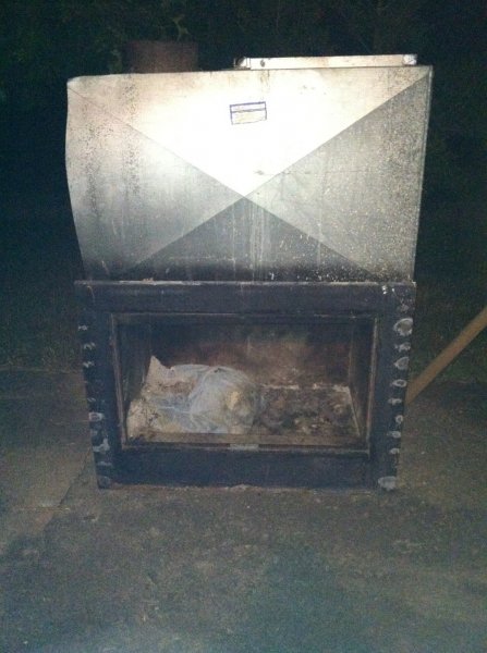

    This beast was attached to cha behind brick wall. Once I removed the chimney my choice was either tear out the wall or turn off drain and move hot water heater all while covered in fiberglass insulation.
    The hearth will look much better once I clean it up and finish laying brick.
    Liner would be most expensive option as 10" needs work to be usable.
    I will finish buying 6" class A with all the accessories.
    WW this was not a slammer set up the chimney was built on top of the fireplace and had to be removed in order to move fireplace.
