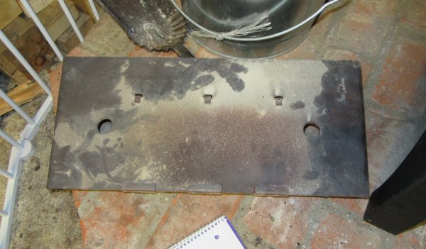

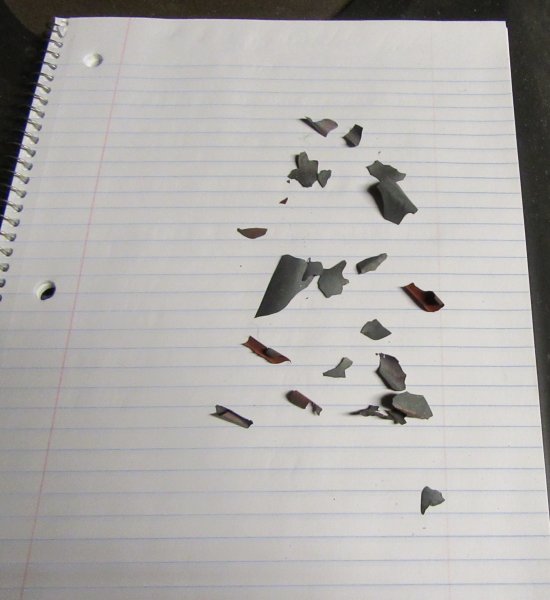

    It finally cooled down enough to open up. The only apparent damage is to the radiator shield above the cat. There were a bunch of metal flakes caught by that stainless shield on the bottom side of the radiator. Those weren't there a few weeks ago before I started burning for the season. The radiator shows color differences that I don't recall being there before. It's still pretty straight, not obviously warped. Otherwise, my condor cat probe is very slightly drooping downward and the long sides of the cat are warped a bit, but they weren't perfectly straight this fall. So I'm not sure how much of that happened last night. It still appears to be sealing to the gasket.
    It looks like I used up a bit extra of the life of the radiator but no other significant consequences. Thanks for the advice and comments.

    So where did the metal flakes come from?

    Your radiator looks pretty good!

    They came from the radiator. The cat was glowing hot enough to burn a layer of steel off the bottom side of the radiator. The stainless steel shield is placed there to protect the radiator from the direct heat. In this case, it wasn't enough protection, but it did catch the flakes and keep them off the cat.
