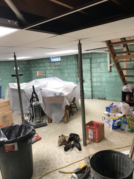

    Here’s a little background to start. We’ve been in the house about 7 years and the basement was considered “finished” when we bought the place. The truth of that is let’s just call it useable for storage :D. This year with a new baby coming we needed our upstairs office to move downstairs as well as a play area for the kids. So let the fun begin!!!
    I had done the lighting as well as fixed up the exsisting drop ceiling when we moved in. Of course some of it was popped out so I could do some other work in the meantime.

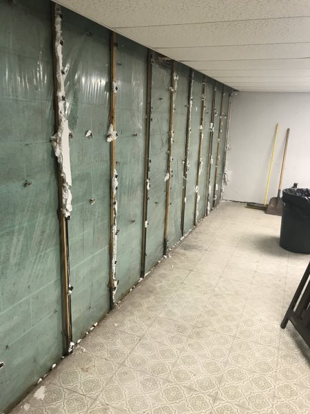

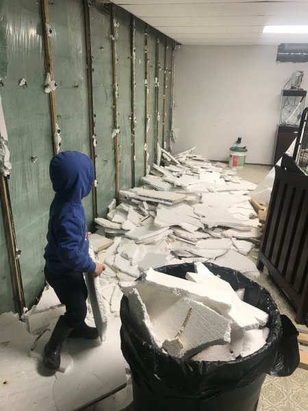

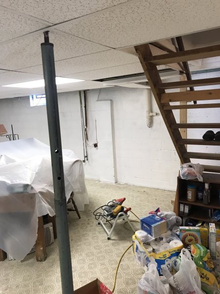

    Block foundation, layer of plastic, firring strips nailed through plastic to the block, 1” white bead foam between strips then 1” beaded foam over top and troweled plaster over the whole wall!!! 09C05930-0BAC-495F-BE3D-22807196AA4B.jpeg
    Tore it all out and busted it into contractor bags one wall at a time! 398AE9F8-582A-40BF-8F43-3B316EC62000.jpeg Some of the block was painted, some not. Here’s a few of the countless bags of busted foam and plaster. CEC2063C-7374-4B85-8A4E-6FE9E95AEE47.jpeg

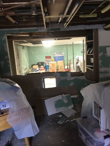

    There was an exsisting wall that split the “finished” area from the utility room area and it had a closet which opened to the “finished” area. My plan was to have it open into the utility area and frame in the original opening. Out comes the sawzall!!! 939080FA-C473-462E-9A48-AA3A275C8CEE.jpeg
    Finished cutting the opening. 4EF7CF0D-03BE-447B-803F-31CE85A0B3D3.jpeg The rest of the plastic and firring strips all down and walls cleaned and drying 3330DB1B-01EE-43B0-AEC7-E697F60C81E2.jpeg

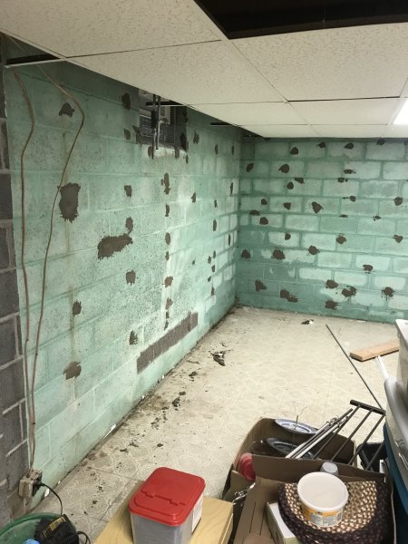

    Framed in the closet. E25F74C5-4216-4A35-8236-B8742A3AED41.jpeg patched some nail holes and repainted some rough mortar joints as well as cleaned out the gutter around the floor edge. D8218883-FA9E-48FD-90E9-F41B4B97B65A.jpeg

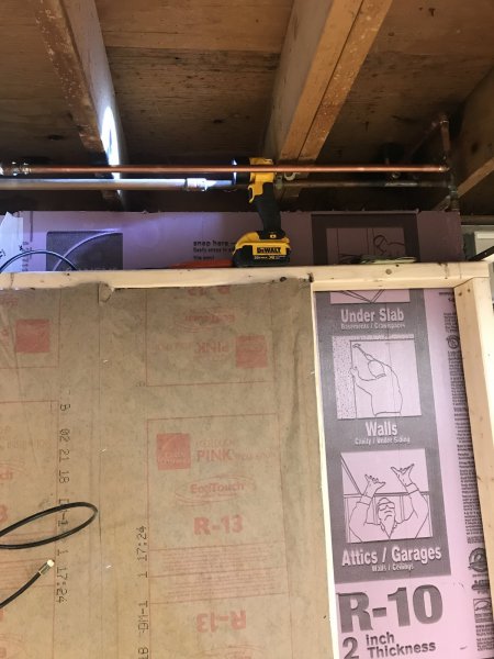

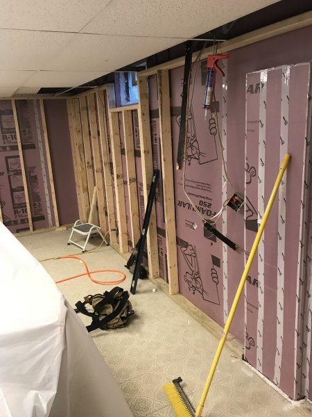

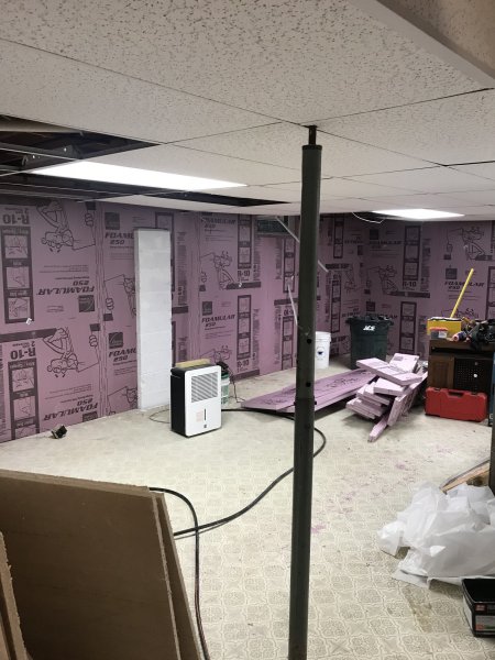

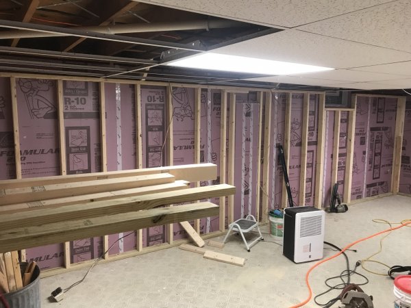

    Glued on 2” ridged foam 67B00C46-E5A3-4E29-9109-06542118C66C.jpeg taped the joints 6843CFEB-8552-49C5-ADAE-86D21BD2BF06.jpeg tapcons for the bottom pt plate and framed 2x4 wall in front of the foam 641BDD38-AB64-489C-91C1-3C2AEC690628.jpeg

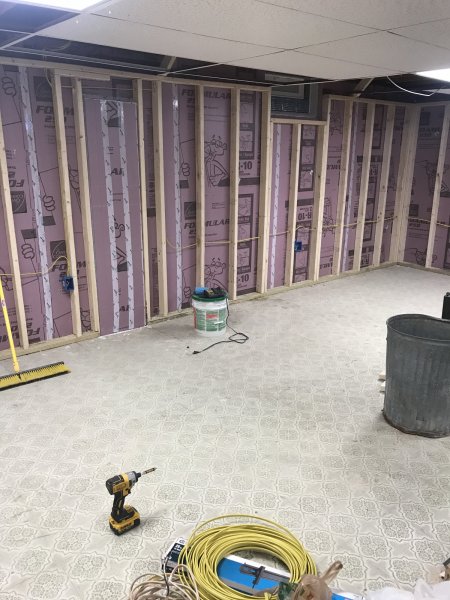

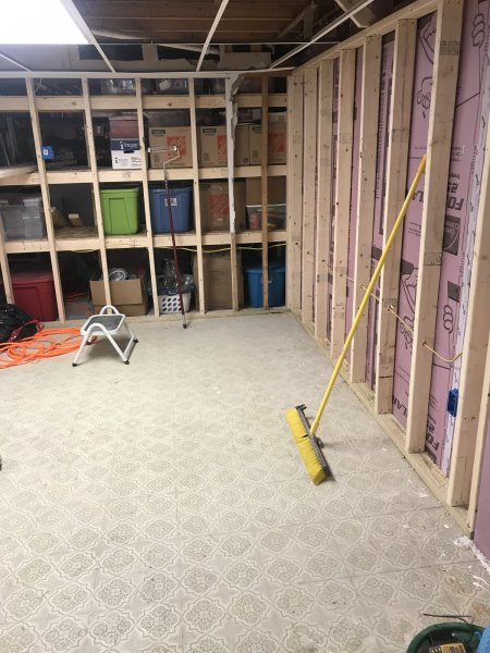

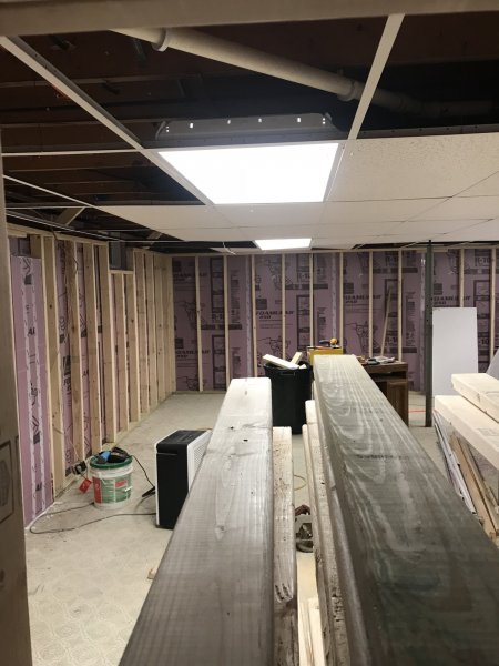

    More framing BBF48845-C1A7-4CE0-B176-551C79DF297E.jpeg just about done 1B411009-7B9B-42CC-8217-8953DFA09F26.jpeg Now to think about the electric. 739C64D5-B209-4FE2-BD22-F49690499C46.jpeg There was one circuit that was feeding the entire room and it was pretty rough. I ended up splitting north and south to two circuits. I even added some coax for a tv and the computer. FF970ECC-5C9E-4E8D-9214-8DA5129316BF.jpeg

    Wrapped up the wiring BE18198F-C9FF-4B0C-8FF7-5F4326125DB5.jpeg in goes the fiberglass

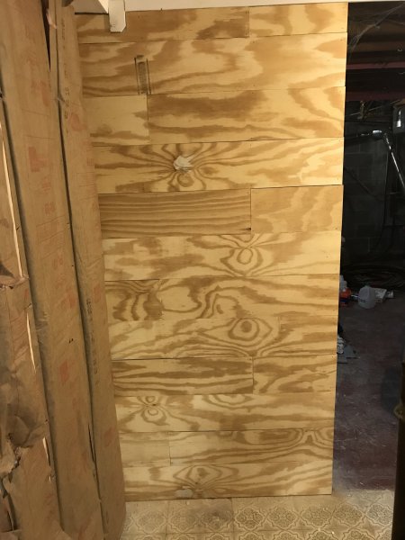

    Then a test section of what we decided to do on the walls. 3/8 B/C grade play wood ripped in strips and nailed up to look like ship lap. 23375A2F-2D3A-416B-9E60-2C7E360F301D.jpeg

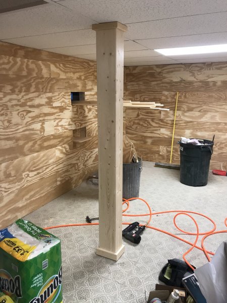

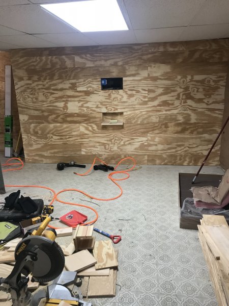

    The heating problem remedied. E47E942F-C71E-43FE-913C-B4EA1C1D1E3F.jpeg Some of the plywood ripped for the wall. Think I ended up with around 25-27 sheets ripped to 7 1/2” strips. Used a good straight 2x with some grip clamps and trusty circular saw. F7D59864-063C-46A5-9617-E0E54FA0C0F4.jpeg Starting to take shape
    The TV wall opening for the back of the tv and the inset shelf for the Blu-ray 39A16BEC-D5A8-4733-99E8-E5729F07568A.jpeg

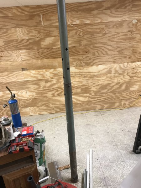

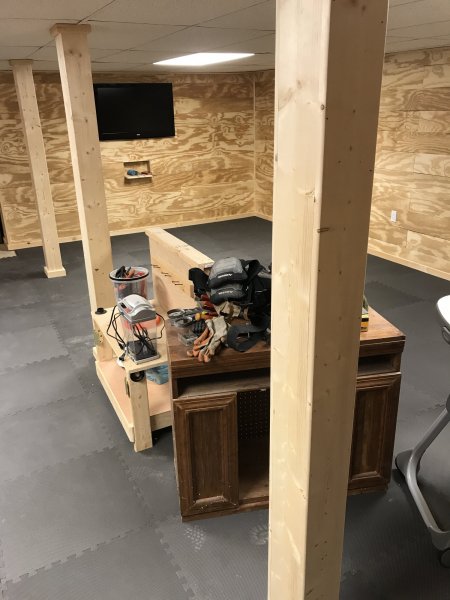

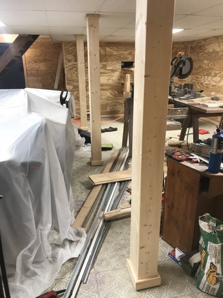

    What to do with the ugly steel support posts? F82B31AB-8C5E-4B72-A1A8-1339FC5F9E35.jpeg 1F30FB83-2883-4C86-B4A7-BA60289EB48A.jpeg 5BB4B836-C863-427C-9162-CC4A1432E005.jpeg there! Not so bad 6A295E2E-A10A-4A1D-9E22-D8E38B0E649D.jpeg

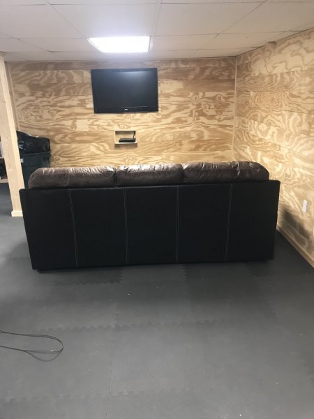

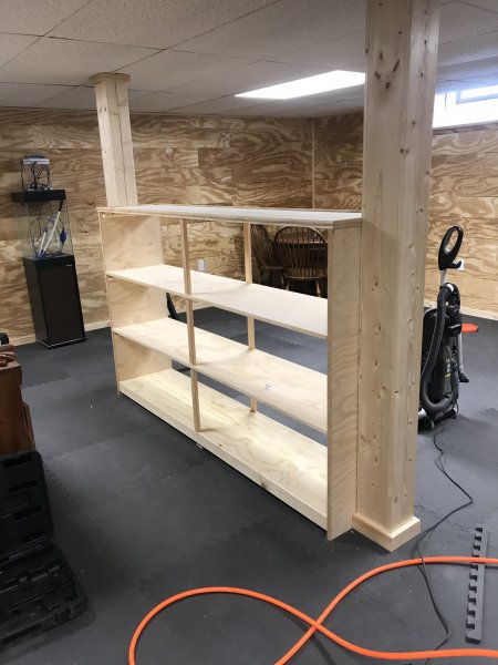

    A bit of trim work B80582A5-2597-4CC0-9B47-1FAE59943EEB.jpeg 38EBF480-087A-4C47-A77F-F5EECB2B2178.jpeg Starting on the floor. We went with a foam rubber puzzle piece type exercise room floor. Went right over the old floor, added cushion, insulation and if there’s ever a water issue will be easy to pull up and dry out! 6817C2F5-6141-4372-B11C-4D4C4BCE3188.jpeg

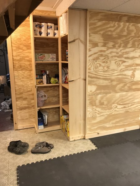

    A few finishing touches...

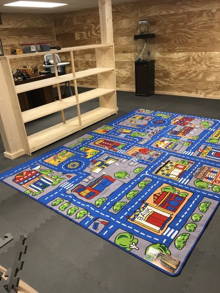

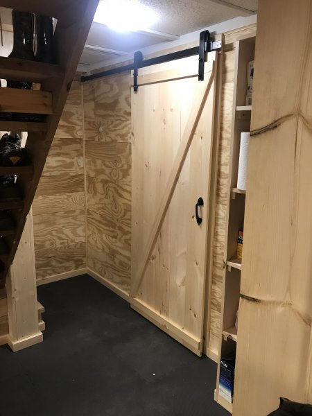

    That the top doubles as a bar top when playing darts 6F00AC4C-A4B0-483F-95E6-183A5380B923.jpeg A corner pantry shelf 107EA744-CE9C-409B-9BF0-1DB2DA976AD4.jpeg Even whipped up a quick barn door! 7C7B7828-26C1-4977-B799-4C45F158995B.jpeg

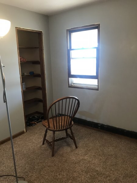

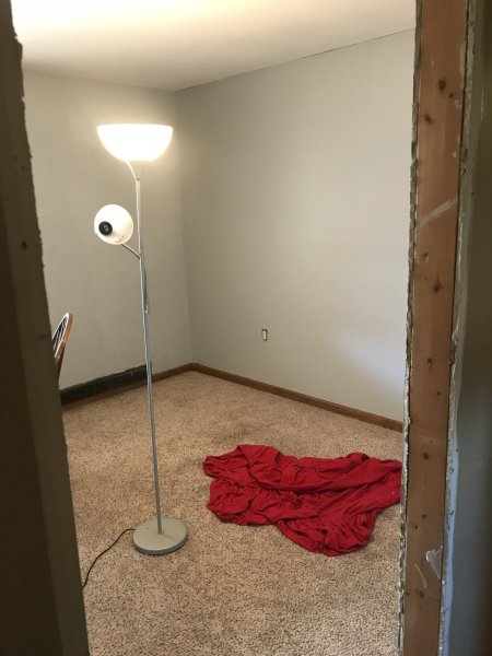

    All said and done started end of February finished beginning of April. I worked on it as much as possible with working my regular job 60 plus during the whole time, so I don’t think it went to bad. I’m happy with how it turned out. We gained around 500 s.f of useable area downstairs and then turned the original office upstairs, with some fresh paint C6084FAA-2793-4E98-92A5-C8539E926821.jpeg peeled all the trim 1CA2C220-8F5B-4977-B7C3-DE2AF763421F.jpeg into the new bedroom with new trim,ceiling fan 9FBB163E-CD58-4EC7-B922-BD2BE45E7EEE.jpeg and doors D2826B76-06A1-45E4-B2C3-E88DC2B9084C.jpeg 170C056A-03CA-4551-B73C-38C9DF17504B.jpeg
