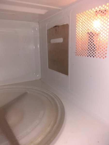

    Probably just need to replace the mica board, and give 'er a good cleaning...mica board is a couple bucks, easy to replace...available on ebay/amazon...you'll be done with the whole deal in 5 minutes...and back to :popcorn:
    Often times food splashes on the board and then over time it gets cooked to a crisp, turns to carbon...then sparky sparky! Any burnt food splatters need cleaned off.

    Ok, so looking on the inside of the microwave, would the "mica board" be at the top?

    I'm not familiar with your model...but most that I've seen, the board is on the right...it covers the area where the maganatron is...here is a pic of mine...that silver board on the right...it's just held in place by a couple plastic pins. You'll notice the black spot at the top of the cover where a previous board did the arky sparky thing...left a stain.

    That looks like the "cardboard" looking panel at the top of the MW, inside. I couldn't find a direct replacement, but cutting one out of blank seems Ok. I have it unplugged but I won't mess with it for a few days, stored discharge and all that. If it works, I'll set it aside for the downstairs when I get that finished. Thanks for the direction on that "mica" board. JB

    Yeah that's the easiest/cheapest thing to do...just order some mica board material...trace the old one, cut the new one out.
