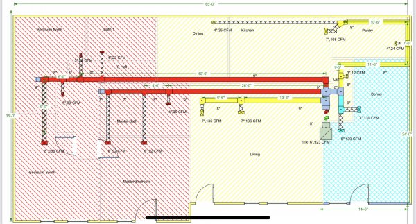

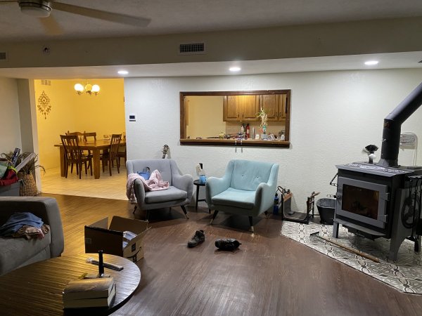

    corner of room. I have attached a picture of my house and the ductwork layout I designed for it. Assume top is N. Wood stove sits in NE corner of LR. Box fan is at SE corner (exterior wall). I will if needed put a fan at the end of hall (NW corner) and have it blow down the hall to the kitchen. Kitchen and dining room are fairly open to LR. Family complains about fan in the way when I do that so only if it is stupid cold for a long period. Otherwise the bedrooms are on their own zone and I let the HP/propane furnace handle it.
    I have been having trouble with this thing running hot and am in talks with WS about it. I am collecting data to help. I will say adding the damper has helped a lot but I am a bit concerned about adding the 8’ of class A pipe. Picture is taken near LR windows looking back to kitchen and dining room. Hall is left of dining room.

  14. yooperdave
    33,507
    205,901
    Regarding your ductwork design....
    I'm having a hard time understanding just how this is configured. Are the red supply air and the yellow return air?
  15. snaple4
    snaple4
    Jan 10, 2019
    94
    303
    Different color rooms are the specific zones for the system (I have 3). The ductwork color corresponds to the zone(s) they are serving. There is a return duct on there (green) but it is just for sizing purposes.

  18. yooperdave
    33,507
    205,901
    For a basement, we would install supply air outlets near the outside walls in ceiling and the return air inlets near the inside wall but down low near the floor. that way, the conditioned air you introduce into the room has to migrate across the room from high to low before it is retuned to the heating unit. This is typical in a northern climate.
    If your returns are on inside walls, your room air exchange may be short cycled and leave pockets of unconditioned air between the supply outlet and the outside wall as the air will migrate to the return air inlets from the supply air outlets.
  19. snaple4
    snaple4
    Jan 10, 2019
    94
    303
    Thank you for the input. That is certainly a common and good way to do the ductwork but not necessarily always the best or possible. A few bits that might have failed to explain: I am an HVAC contractor by trade, not one part of the ductwork is original and it keeps most of the house even on temperature as designed, this house isn’t exactly a basement (it is designed like a walkout basement but there is only one floor), with concrete load bearing walls and ceiling it limits the placement and size of ductwork.
    I am a fan of sidewall termination blowing along ceiling towards outside wall. Not only does this reduce the amount of ductwork but airflow will actually cling to the ceiling so to speak for a distant; we can figure that distance based on velocity and such and this helps the air travel further into the room. This is a design I had to utilize in the house and it works great. Really only problem with comfort is due to not being able to fit the designed size pipe to an area, the exposed outside wall having only 1” foam board for insulation, and a child who keeps opening the 40 year old windows that won’t close back very well. Couldn’t really have a 6’ ceiling to fit ductwork so until I add insulation somehow I will have one room that gets a bit cold in the winter and a bit warm in the summer. Still not uncomfortable though.
