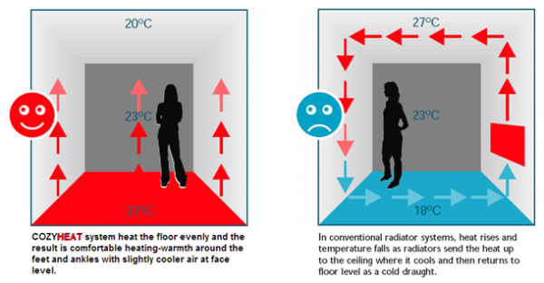

    A heater often gets a localized warm air rising drafty circulatory system moving in a room. The circulation and draft is welcome in the Summer, Winter not so much. Warm floors is often advantageous with a basement install stove.
    Edit: IMO, the cold ceiling on the graphic on the left is a bit of an exaggeration.
