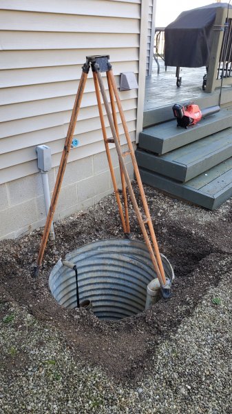

    Remember too, you’re gonna have to release the come along to swing the old pump over to firm ground, unless you think you can play Twister with that opening and your transit tripod to lift it off the come along’s hook…

    A chain hoist would work a lot better than a come along/cable winch. Careful what your buying a quality winch is a lot more expensive than a wench but the long term cost of a wench far exceeds what you would have spent on a winch.
    If I had the time and inclination I might make an oversized sawhorse instead of the tripod.

    Not a bad idea at all...who knew you would have one of those ;)...so how far did those pointy feet get driven into the ground then?

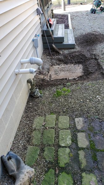

  20. eatonpcat
    9,691
    54,082
    It's out...
