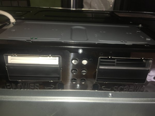

    In this case the old LG Microwave was 16-5/8” high and the new Kitchen Aid is 17-1/4” Heigh or 5/8” higher!! The mounting bracket for the LG was mounted to wall and the tile backsplash is tiled right up to it so the bracket could not be moved down without breaking the tiles!
    Yes, maybe plywood could be placed above the tiles and fastened to the wall so the bracket could be moved down and overhang the plywood and the bracket could still be attached 5/8” lower.
    I went with a faster and cheaper option of carefully removing the cabinet screws and outlet in the cabinet and the cutting the nails with a saws all to remove the cabinet from the wall and remove the doors so 5/8” of the bottom could be cut off and then re-installed on the wall. :)
    The Microwave could then be installed on the old bracket and new holes had to be drilled in the bottom of the cabinet and the new microwave could then be installed!! I may add a trim board along the top of the microwave later, just doing this took 2 days!!!

    Pic 3&4 - Change Blower to blow out back of house from blowing down onto range.
