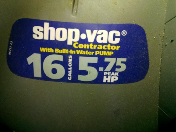

    The wet vac i have, has a garden hose connection. It'll pump itself out.
    It also has a flat, hard plastic piece, to lay flat on the wet surface.

    Do you know what model?
    This flat, hard plastic piece, if you can post an online pic, appreciated!

    I seem to have kept one from an older vac. They both measure 8.5in in width.
    I have had this one for a long time.
    It hasn't been used much, since having a French drain installed, in the uphill side of our house. Water was finding it's way in to our unfinished basement. Cement floor. The wet vac dealt with the water just fine. Not automatic, as with a sump pump.
