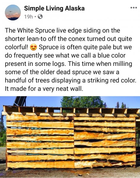

    Just saw this on my Fakebook feed this morning. If it has lots of knots from limbs, I don't think it would make great finish wood.

    My friend that I get the logs from needs to build a chicken coop and was thinking of using slabs for the exterior siding. Maybe live edgeing them like this guy did would work well for that. Put the Thompson's Water Seal on them.
    Maybe do a board and board instead of a board and batten. ?
    Might look pretty good. ?

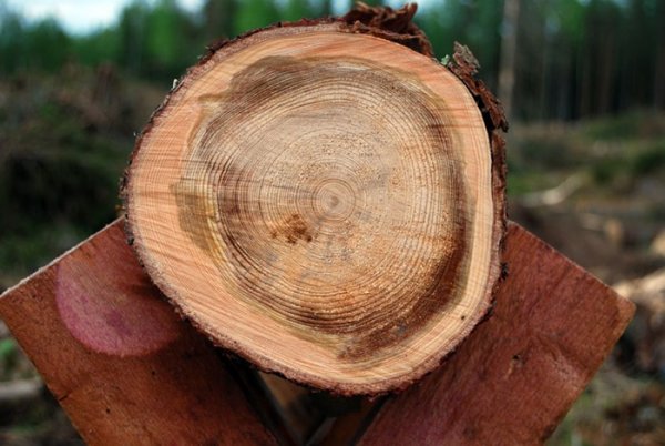

    Not the best pictures, but did it look anything like this? Some of the boards picture of the wall above look like and these below are examples of root rot. It looks good on a mill unless it’s advanced to far.

    Didn't look exactly like that. It's a lightish orange with white flecks in it.
    Often times it has very little structural integrity to it. And it's a prelude to the tree becoming hollow.

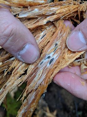

    The specks are the fungus, the loose integrity is the result. I’m guessing something like this, or similar, this is pretty advanced. There’s several varieties of the disease. Lots more google pictures if anyone is interested. A few times they wanted samples, stump branding, stump counting, stump painting all sorts of crap. Between this and beetles a stand doesn’t hold much hope, if both infest at the same time ha g in to your hat it will destroy the surrounding area very fast.

    Yup. That's it. The butt of the particular tree in question was real soft like the pic.
    20+' up the tree it got Sounder . But was still orange.
