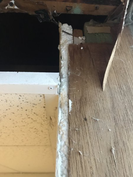

    Excuse the cobwebs and spiders :rofl: :lol:
    This is a shot of a window well and it gives you a good shot of how it’s done right now. The blue/green is the block then there is a 1” firing strip shot to the block with 1” foam between them. Then 1” of foam over that giving 2” total away from the block. Then the drop ceiling rail is tacked through the foam into the fitting strips all the way around. I plan to deep six the foam then go with an air space(1”?) frame a 2x4 wall with 3/8 drywall on the outside. I’m thinking, providing that 1” airspace is adequate I will just frame the wall so the drop ceiling sits on top of it then run a piece of 1x or something a bit nicer around the top to dress it up.

    Basements are tricky to get right. From you pics the "foam" used is the wrong kind. Vapor barriers are a no no these days, they trap the moisture. the only way to properly finish a basement is;
    clean and seal block
    install foam onto block as a thermal break taping and sealing every possible gap seam void., the block is cold and the basement air is warm.
    frame wall and insulate the cavity with no vapor barrier, paper backing
    research it online, any other way will create condensation and eventually grow mold.

    Follow ironpony advice as does look like wrong type of foam. Why I wanted a pic. Better to do it right than get mold and do over.

    The foam is wrong was the first thing I noticed too! It’s got to be like a sponge! I’m worried about what I’ll find back there but weather I do nothing as far as framing goes or not I’m going to tear it out and seal the block at very least.

    I’m liking that advice as well! :thumbs: As far as the picture it’s the work done by previous owner which so far I’ve noticed nothing here has been quite right:picard:
