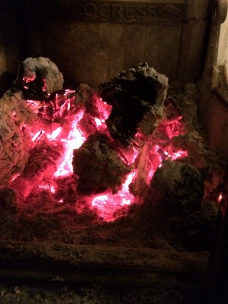

    IMG_1169.JPG We purchased a Progress Hybrid last summer as the ideal steel looked to utilitarian for my wife's taste additionally the left side load works better for our layout. Had a little bit of a learning curve but here is a picture of the progress hybrid after 10 hours burning on low with a medium size load of oak. STT is ~ 275-300 and will hold this for at least another 3-4 hours. Mid 20's overnight and high 30's in the day heating 2500-3000 sq foot on low easily depending on what parts of the house are in use.
    You can't go wrong with either stove!
