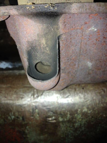

    Recently talk of old 044s and new 044s and 440s mufflers I decided to show opening one up. I did this to a couple already and it really changes the saw for the good.

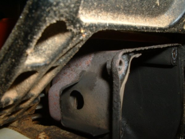

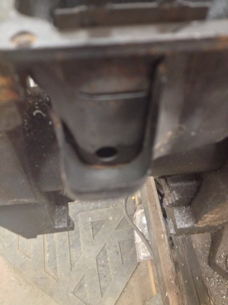

    Big difference in the two.

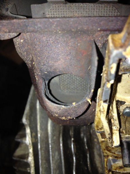

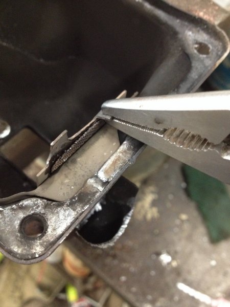

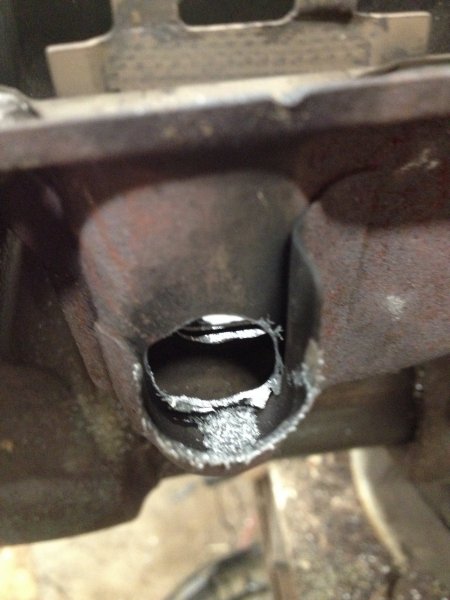

    2,416

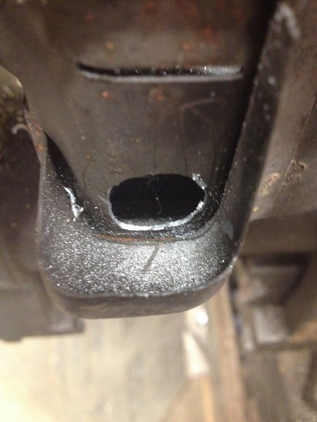

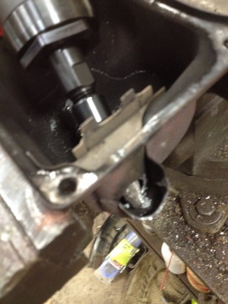

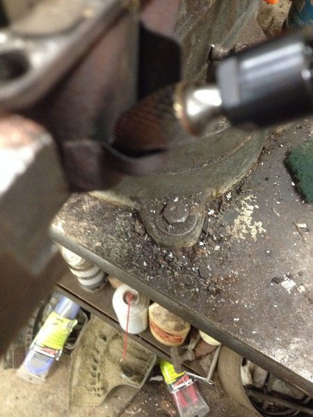

    Fortunately I have access to a lot of cool tools at work so I got out the angle air powered grinder and a carbide burr. image.jpg image.jpg I went on the outside first then on the inside to get way down in there.
    And here is the finished result. Looks ok to me. Run the saw a little bit and the soot will cover up the shine.

    One last thing is to put back spark screen. :)

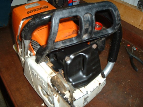

  7. Cut4fun
    Cut4fun
    Mar 18, 2014
    1,941
    3,571
    OHIO Redneck
    Before and after on a 036 rebuild.

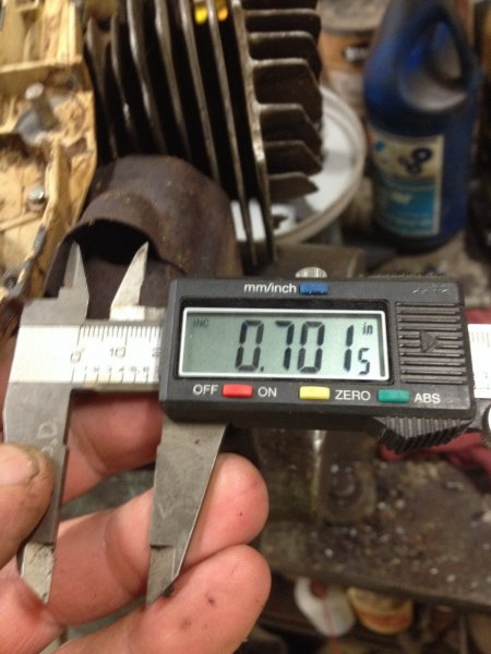

    Hey, what is the old-school diameter, exactly?

    I will have to measure it when i get to work tomorrow. The saw is on my bench there.

  16. rookie1
    rookie1
    Dec 29, 2013
    938
    2,416
    Sorry for the delay Jon. It's .7 inches. I'm not real precise but that's close. image.jpg

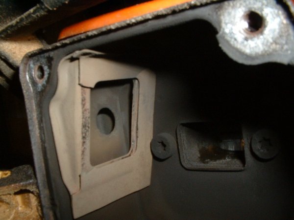

    I've got a MS460 to work on and looked at muffler outlet, then opened it up!
    Before pic. Opening was about 5/16.
    After pic. I opened it up to 9/16.
    I'll bet the dudes happy when he gets it back. :D
