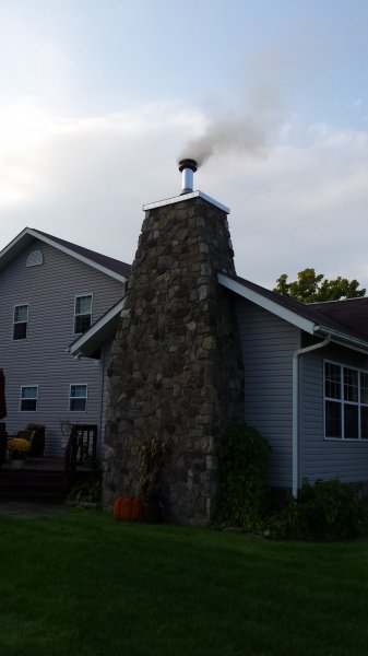

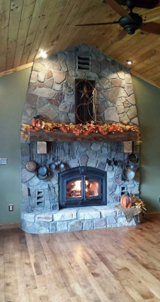

    I have a modern, very highly efficient ZC (zero clearance) fireplace. And it gives the best of both worlds! It's a Napoleon NZ3000, and it's one of the most amazing heaters I've seen yet. Here's our fireplace, and it's still almost 80% efficient!!
    Outside view......

    Wow, that is nice, I like the way it angles in at the top. I want to do something on the wall behind my stove. I see what looks like a vent at the top and two down at the bottom. Is that air circulation to pull heat off the top and out the bottom?

    Thanks, Kim! Yes, those are stone registers that allow circulation in the chase. These ZC fireplaces are built in a "chase", or kinda like a closet. That's all done to strict guidelines supplied by both local codes and also manufacturers specifications. It's then stone cased.
    I made those vents out of flagstone to match the rest of the stonework. I built it myself, there's a thread about the entire project on our site somewhere.....

    Nope.....it is fully insulated and almost all the heat comes out via registers and the front of the stove. It heats our 2800sq.ft. home very effectively.

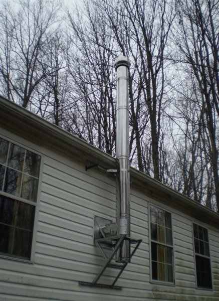

    Here is a photo of my chimney; not the best photo and I have a better one somewhere. Pretty? No, not really. If I had the money I would frame it out and cover with stone veneer; leaving an access panel to get to the clean out for the chimney. However, there are many Class A chimneys in use exposed.

    By the way, I built that chimney myself, designed myself; with some advice on the forum, the support bracing. I couldn't weld so that is why I went with the slotted; thought about seeing if I could get a welding shop but there was no money to hire welders. Dad could weld but I never got him to teach me. I had to do a special support because I needed to offset more and did not want to cut into the facial board
