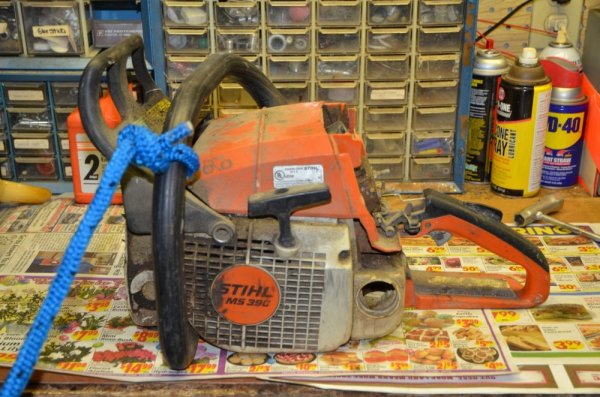

    It's a 361... Unfortunately it doesn't run. The guy just put a brand new oem handle, coil and brake flag on it. Then melted the piston.
    He bought a aftermarket cylinder kit and bolted it on and couldn't get it to ever run again... Took it apart three times and can't figure out what's wrong.
    I paid $100 for it. More then I'd usually pay for a project but it's complete with lots of new parts and no cracks or breaks.

    Filter cover on the 360 is a bit different and the decomp would be dead center. 361 it is. :)

    Oh the saw on Mikes photo has a decomp alright. See it on the right side of the saw? ;)

    WTH? What happened? And what does the cylinder look like? (not good I imagine...)

    The cylinder isn't as bad - - a couple corresponding grooves above the upper transfers. Might be able to be saved by raising the transfers?? The grooves probably go too high though.
    My guess is there was something left in the crankcase when he rebuilt it. The clips are still there.
    The story I got was that he rebuilt and had lost and forgot to put the wrist pin bearing on. Didn't sound right when he pulled it over. Without running the saw (supposedly) he got a new bearing and put it in and couldn't get the saw to ever run. I don't know if the lack of a bearing could have caused this or not?
