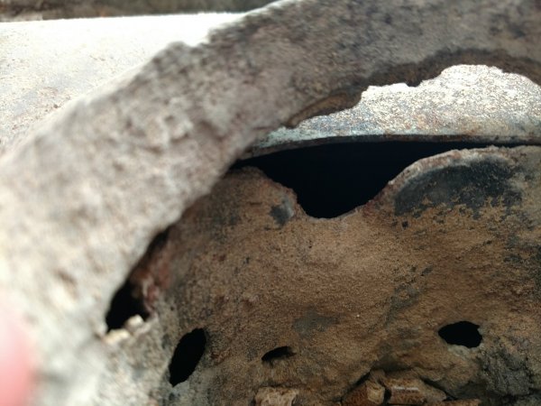

    I thought this was very interesting. I bought this stove to flip (I looked at it a few weeks ago) and never saw anything like this firepot.

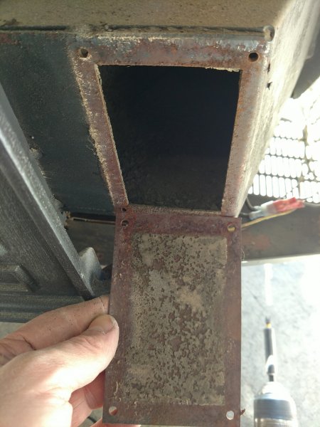

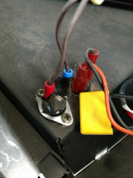

    This stove with the rotted pot was sold like this to the person I bought the stove from. It was sealed up around the outer edge of the pot with some type of stove cement or grout. Going over the stove I also noticed the the gasket is missing on the clean-out cover and they also didn't put insulated terminal connectors on the wiring going to the snapdisk, choosing instead to place electrical tape on it.
    Has anyone seen a rotted pot like this before? In the 11 years or so of burning I've never seen or read of one of these thick cast Quad pots rotting out like this. I wondered if this stove was burning straight corn of something at some point.
    I typically wouldn't ever throw a company under the bus but the stove was sold by Seasonal Emporium in East Stroudsburg, PA. If you get a chance, Google them and look at some of the reviews.....crazy. BTW, they are still in business and constantly advertise stove repair on CL.

    yikes!!!! burning road salt cause its cheaper than maeder bros.

    Steve, only time I've seen cast degrade like that (here) was due to sitting in a wet environment for years, absolutely neglected.
    The stove shop sold them the stove w/ that burn pot, in that condition? Crazy. :loco: :crazy:

    Yes...he paid $2100 for that stove...when I first went to see it it was mostly sealed with that grout around the pot but it was all cracked. I picked at it when I was there and it was just falling apart.

    That "grout" looks like Rutland high temp. stove cement - remember that well from the wood stove days: sets like black concrete, always took a sharp chisel to remove it here.
    Burn pot aside - the rest of the stove looks amazingly good, from the pics.

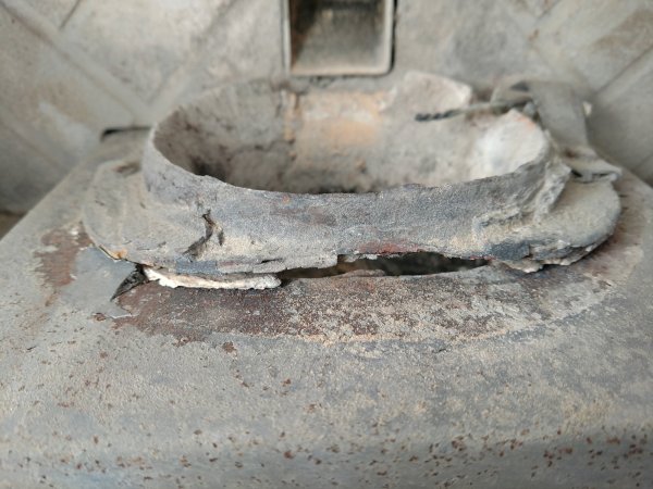

    This is what the pot should look like:
