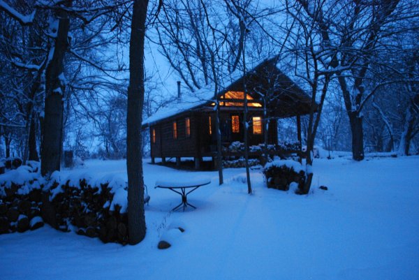

    Planned to upgrade an OLD potbelly to a Woodstock Soapstone "Keystone", but it seems that the price of the steady heat and long burn times (and efficiency) is being comparatively slow to heat. I get to a small, <600 sq ft tight and well-insulated cabin (high ceiling, tho) after work and can get it from 15 degrees to 60 degrees in an hour, then slow it down for the rest of the stay. That's great when you're arriving late. However, even burning gnarly old hedge at night it needs to be refilled about every three hours to still have good coals in the morning. The intended upgrade was to have a visible fire and a better cooking surface and burn through the night. Hearing a lot of general comments about soapstone stoves taking a long time to initially heat up, so it sounds like I may just have to live with the old potbelly, which is inefficient but very flexible and does what it is told. Fortunately, good DSC_0125c.JPG firewood is plentiful and handy. And it's not hard to get back to sleep in the winter! Would appreciate any experience with Woodstock Soapstone "Keystone"/"Palladian "or "Fireview" in small, tight cabins only used for a few days at a time.

    First off, in central Illinois and 600 sq ft to heat a well-insulated cabin, I have to say the Keystone or Fireview would heat you right out of there. Therefore, I would tend to guide you away from the soapstone. You are somewhat correct about the soapstone being slower to heat up because you need to get the stone warm but then it warms fast. A steel stove will warm things much faster. For what it is worth, when we start a cold stove, it does take 30-45 minutes to get much heat from it. Also, the soapstone give a more radiant heat, which means it will warm the objects in the room vs the more convective heat given off with most stoves. This will mean you get a "softer heat" (yes, there is something to that) vs the more harsh heat you feel especially when close to a steel stove. It also means it will heat further rooms much better. But, let's talk about a different stove.
    Woodstock is now also making several steel stove that are also hybrid stoves, which means you get the best of both worlds. The Absolute Steel is a great stove that also give you excellent control of the heat plus a good long burn time. An even smaller stove would be the newer Navajo stove but sorry that I can't talk a great deal about this stove just yet. To read about this stove, go here: Woodstock Soapstone Co. Blog: Search results for navajo
    One nice thing about the Absolute Steel stove is that you no doubt won't have to get up in the night to put wood in the stove and the cabin will be nice and warm in the morning. To read more about this stove, go here: Woodstock Soapstone Co. Blog: Absolute and scroll down to the last entry in that blog.

    Thanks for the great info! (Hope this is the way to "reply" - if not, apologies!). Cabin is R19 in the walls, R30 in the ceiling, R38 under the floor. Always keep a backroom window cracked to bring cool air across the bunk on the way to the stove - the built-in outside air on the Absolute Steel would have been great if I'd designed for it! Mike at Woodstock also recommended I consider the Absolute Steel - I rejected it prematurely for esthetics ( a quick glance during a phone call) but have now come back to taking a hard look at it in its "plainer" configurations. Does the soapstone firebox liner provide some of the "softer heat" you and others have mentioned?? Re heat output, the mfr rates Keystone for 800-1300 sq. ft., the Fireview for 900 - 1600, and the Absolute Steel for "up to 1800 sq. ft." Since they don't quote a lower limit, that seems to support your point that the Keystone or Fireview wouldn't throttle down to a small cabin as well as the Absolute Steel - if I've misinterpreted this, please let me know! The literature I can get my hands on doesn't mention cooking on top of it. No gourmet chef here - just like hot coffee and soup/stew/simple fare. A few of the Woodstock stoves clearly mention cook-tops; so when nothing is said I have to wonder. Bottom line of all this, tho, is that the Absolute Steel becomes a contender and you feel the Keystone may just be a bit much - great intel and appreciate you taking the time to help! I would probably look hard the "high style" just because my stove corner was sized for a 48" potbelly back 1o years ago.

    Sorry about the vagueness. Cabin is in 100 acres of woods surrounded by the family farm (1841!!) - only a few miles from the office in a straight line, and the office is across the street from our tired old home... but still takes at least 30 minutes to get there. So it can be dark by the time you get to the cabin after work, whether it be to hunt the next day or just to goof off, and having the cabin warm up in about an hour is great. We rarely use the cabin itself more than 2-3 days at a time - as you say, "once in a while" - but it is also just a nice "place in the woods" to relax with a good book and watch the critters. The best deer stand is about 150 yards away. We are off the grid and rely on the quiet 2KW Honda unless we're using large tools out there - would be nice to have a stove with a window after the generator shuts down! You're certainly right about the propane backup - but we've kept things pretty simple (austere?) s0 far. Based on what I'm hearing now, my concerns about slow warm-up times may be more than compensated for by heat quality and burn times. Thanks for the info - and NICE C-130! My guess would be the E model... but I'm getting old. Thanks for the thoughts!
