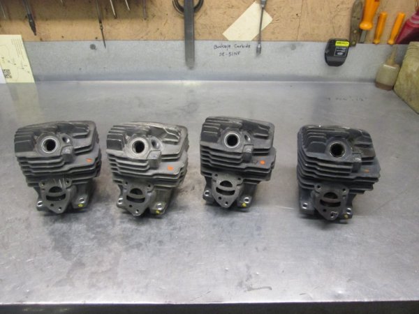

    A great idea for a thread.
    I agree that my threads are not geared to help the guy that just wants to learn how to swap parts.
    Here's my bench as of a half hour ago........MS261 top ends everywhere. :D

    Is there that much difference in color from Casting?? Or do some just have more time than others?
