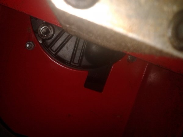

    I looked and maybe I'm blind. Anyone got a pic?
  4. bogydave
    You mean like a allen head inny ?
  5. Well Seasoned
    83,785
    Just ran out and took a picture. Sorry it kinda sucks, had to climb over equipment in slippers. Use a socket wrench w/o the socket attached, will work best. It's the recessed bolt in picture.
    firecracker_77 likes this.
